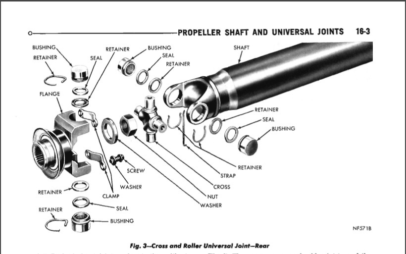

I see what you mean about a yoke with retainer U-straps such as at the rear. Unfortunately this was for the yoke at the front. You would think Mancini would have thought about that since I purchased it with the yoke.

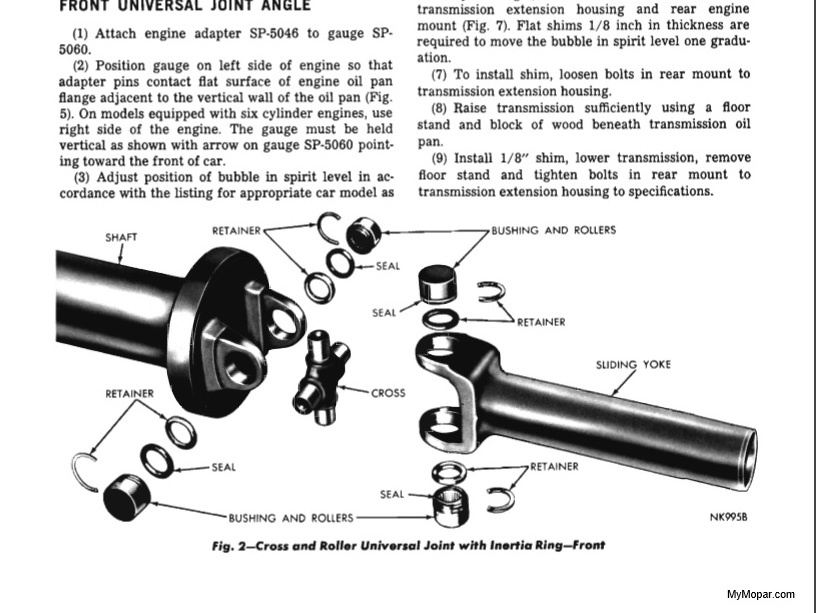

Here are two illustrations from the 69 manual. This is the only way I have ever seen them. The only thing for replacement rear joints, I have never gotten the looped clips, just internal C-clips.
The only thing I can figure is that the clips are placed loosely around the trunion before putting the caps on and then the little bump out part used to apply pressure and force the rest of it around the seal and seat into the groove. Seems like standard C-clips would work just as well except as someone said - they also used it with tie wire or something to keep the caps in place until installation.
