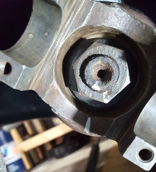

Just changed my seal.
Marked the yoke, pinion, and nut with a paint pen.
I figure there's a margin of error, under the car, dirty.
Came off fairly easy with a 90psi gun.
Back together, pipe wrench on yoke rock steady, can't get it back to my so called mark.
Turned up the psi to 100+, worked it back and forth a few times.
Don't have a 240 wrench.
Breaker bar with jack handle on it, but not enough room under car.
I don't feel any play, back and forth, up and down.
New seal was driven home all the way.
Send it, or am I sol?
