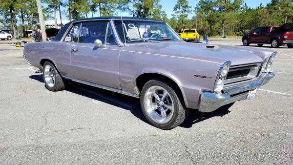

We are going, and we're bringing the 1965 421 Tri-power GTO. I'll post some links.
My wife rode shotgun for the 1st and 2nd 1320 pass in the 421 Tri-power 4 speed GTO. My 1st run was 14 flat, about 1/2 second better than last year, so I was enthusiastic about the improvement, figuring the Drag Radial was going to stick. Came right back around for 2nd pass, a little more aggressive off the start and...tire spin in 1st, so I lifted slightly and then stood on it...POP! I believe that I broke something in the original OPEN rear end on the GTO, so I'm about to go back with the trailer to pick it up from the track.
Actually, best case scenario is the rear end because now we have an "excuse" to get the 9" Ford based Currie rear axle with the posi chunk. :)
Pix and video links along with more posts tonight.
