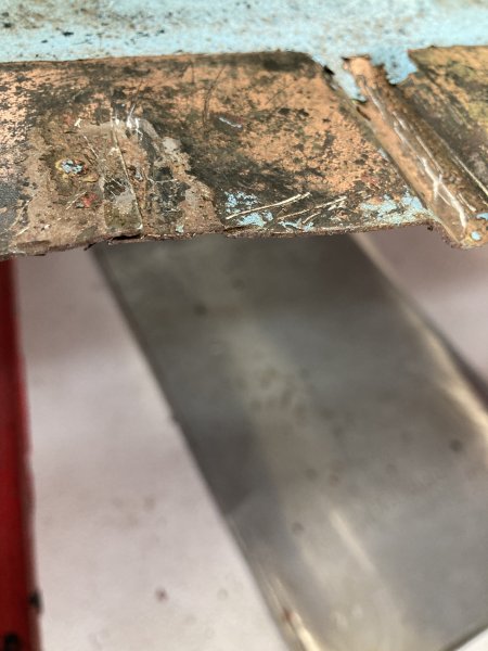

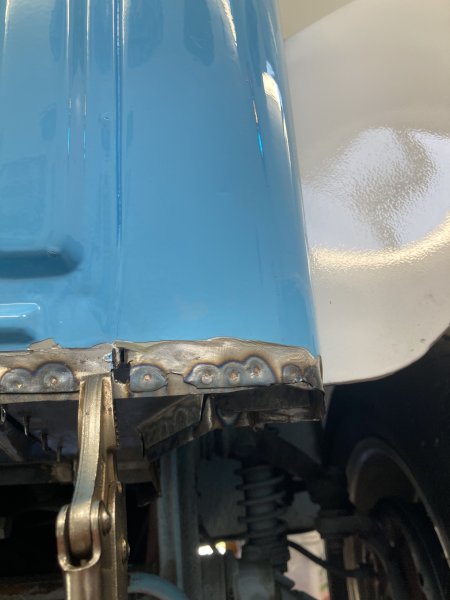

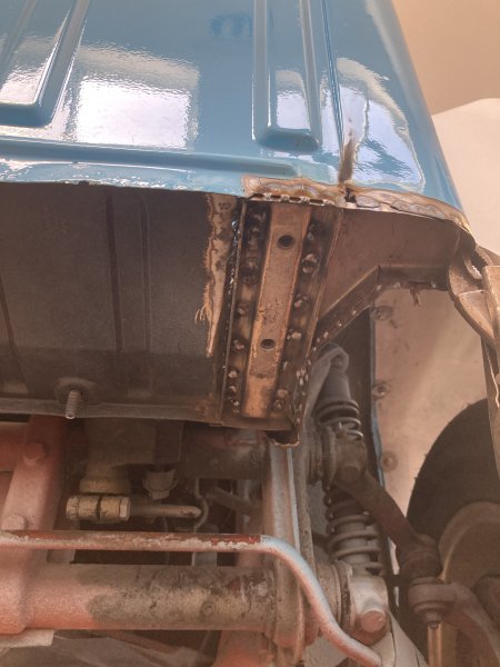

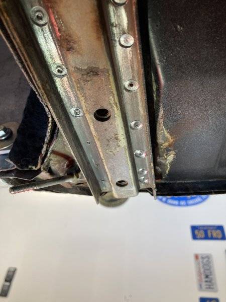

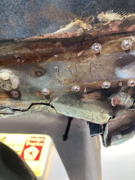

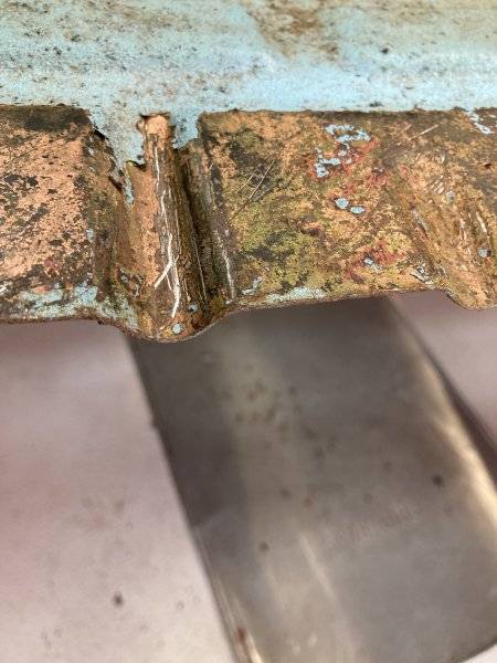

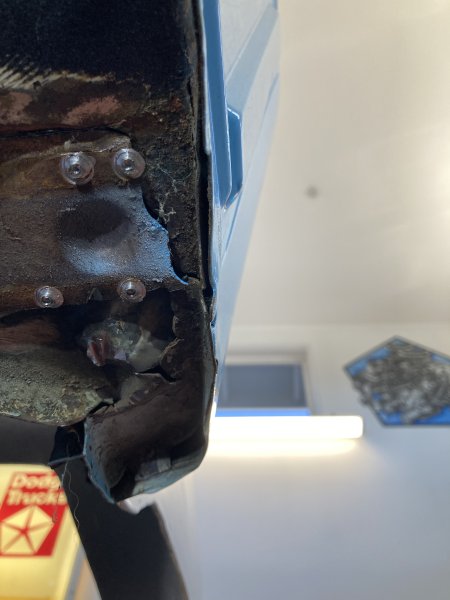

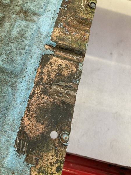

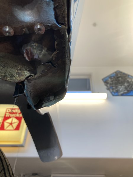

Started working on the first area to be repaired today. Sometime in its past, the car had this under area shoved up enough the stretch and tear the main panel where the bumper bracket welds to. I was trying to see if I could just pull the damaged portion down and do a quick weld etc. Thats when I discovered the additional damage. I cut the spot welds on the bumper bracket to get at the problem area. I'm going to cut the damaged stuff out and make up a new portion to fill the hole back in. From there weld the bracket back on.

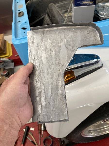

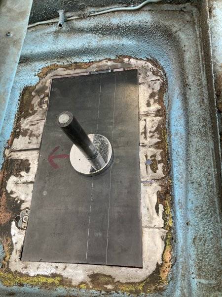

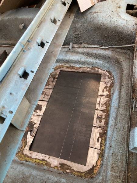

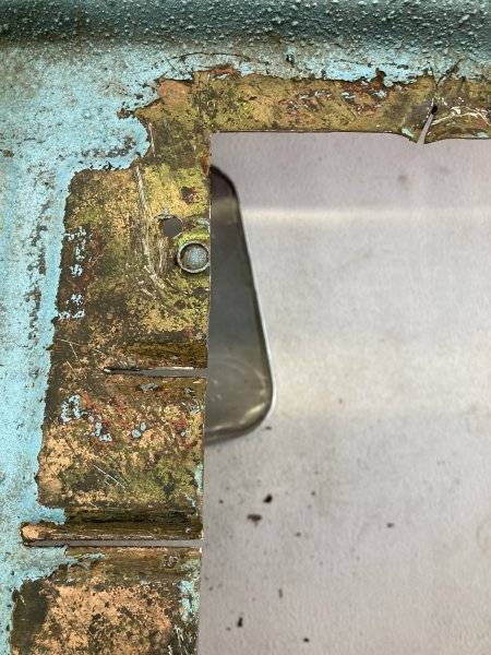

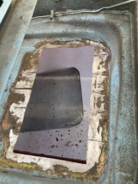

Got the damaged piece out today. Once I had it somewhat flattened out I made a template. Transferred that to a piece of 20ga material. Cut it out, roughed it up with a Hamburger wheel, wiped it down with Acetone, let it dry, then sprayed it with Ospho. After lunch I marked it out to bend up weld flanges around most of it. Thursday I'll continue fitting it up. A friend said he has a spot welder, so thats what I'll use for most of it.
Just about ready to weld the patch piece in. Got it fitted up fairly well, paint/grundge etc buffed off the weld areas. There was a bit of additional damage to some of the surrounding pieces, but I've got most of that stuff dealt with. Tomorrow after I give Tiny Boy[ Zeke] a bath, he's been itching quite a bit which the special shampoo will take care of, I'll get the welding done.

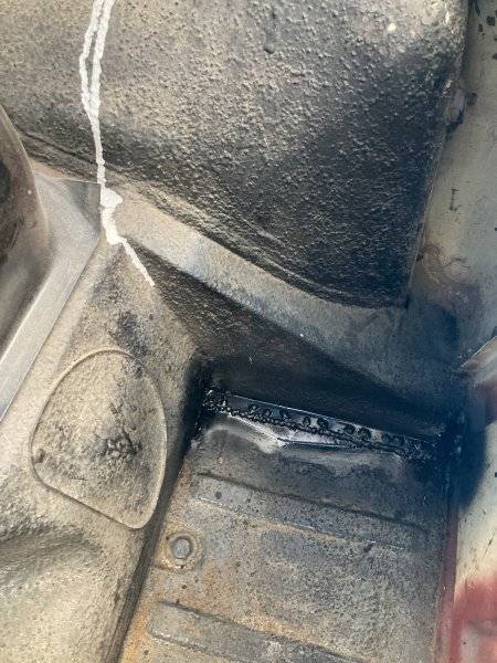

I got most of the welding done on the patch piece today. Started off with the spot welder, an old Miller unit. From there used the Lincoln MIG unit. Tomorrow I'll finish the welding then get some coating spritzed in/on.
Today I finished up the welding. Took a wire brush to the areas of welding, cleaned out the spall with the vacuum, masked a couple of areas off, doused it with the frame spray. Tomorrow I'll put the seam sealer on then work on seat mounting.

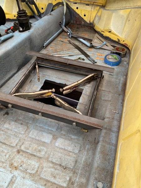

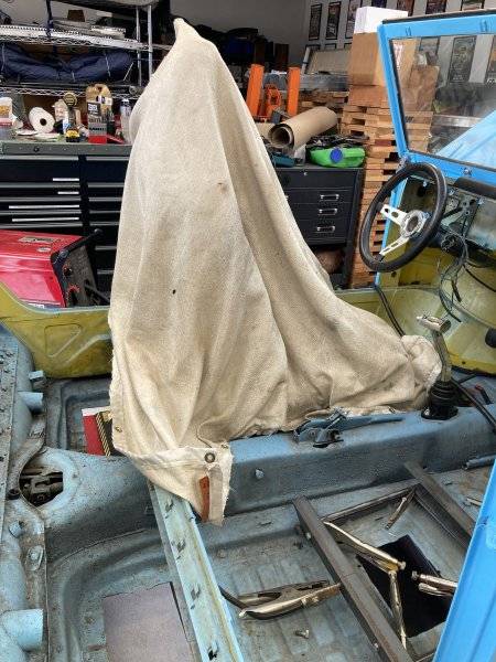

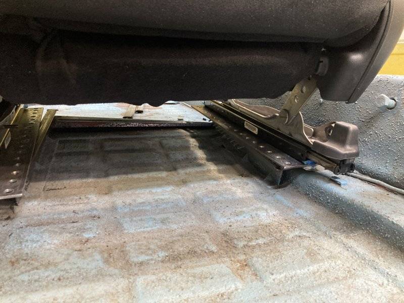

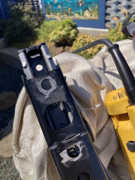

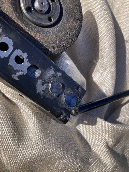

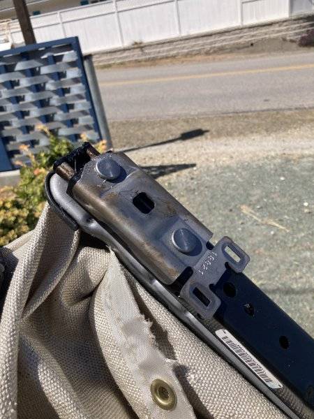

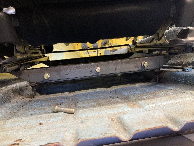

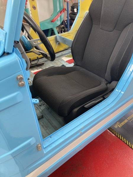

Did some seam sealing on the topside of the "trunk". Finished grinding rivets down and cutting the rest of the brackets off the seat. After that, I TIG welded the remaining portions of the rivets to the tracks. Drilled some pilot holes in them in preparation for going larger to enable a tap session. I figured using 5/16" fine would work there and give me the most thread purchase possible on the rivets. The rivets will be the captive nuts. 8 bolts per seat. Drilled the strap material for plug welding to the existing VW floor frames, the long string of holes 1" apart, plus 2 per end for the seat tracks. Continue tomorrow.
