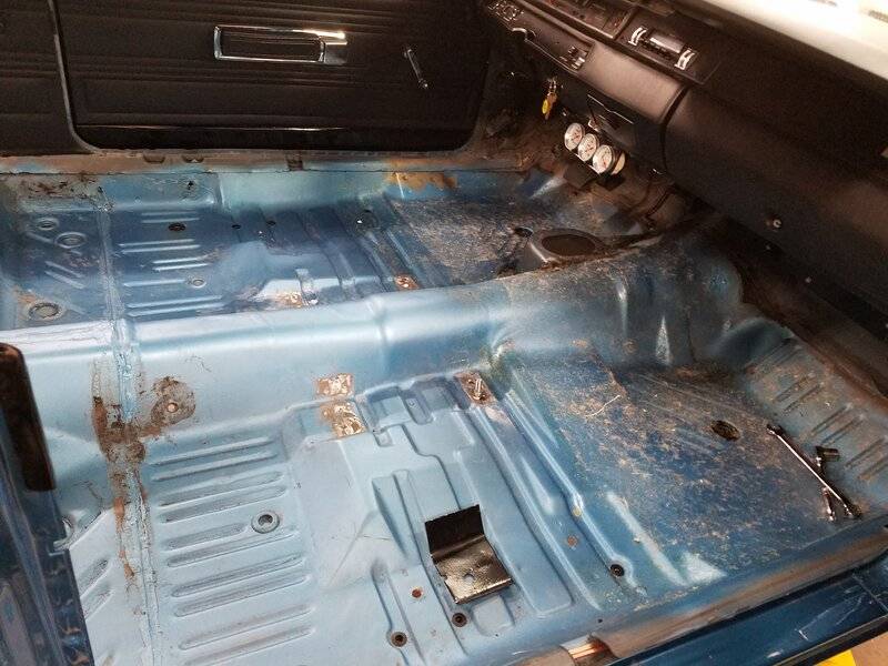

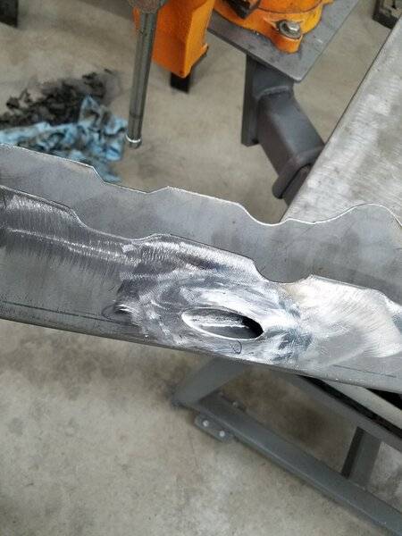

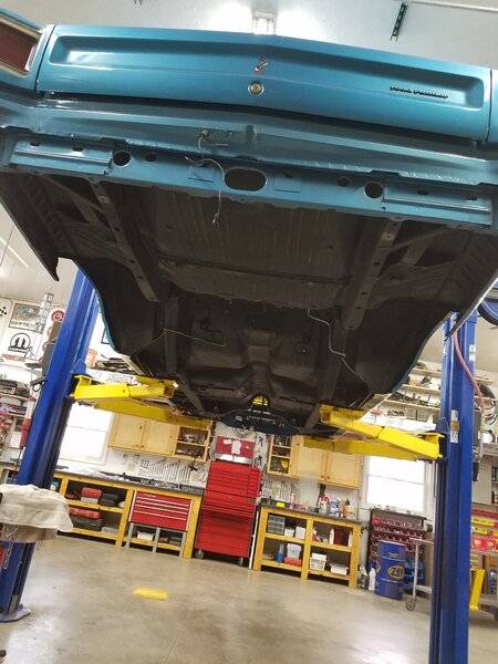

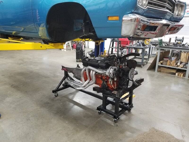

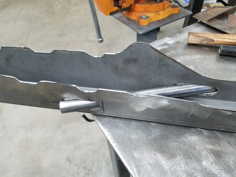

Yes on the whole she-bang. Will be going on a rotisserie so I can blast, epoxy, and paint the bottom. Already started modifying the connectors for the e-brake cable.

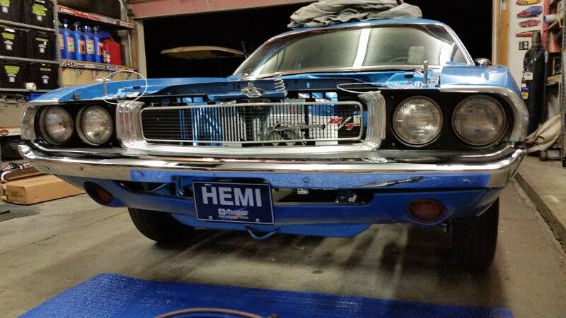

I made one similar to the US Car Tool rad support and added a tow hook for out at the track just in case. It is now also my tie down while in the trailer.
