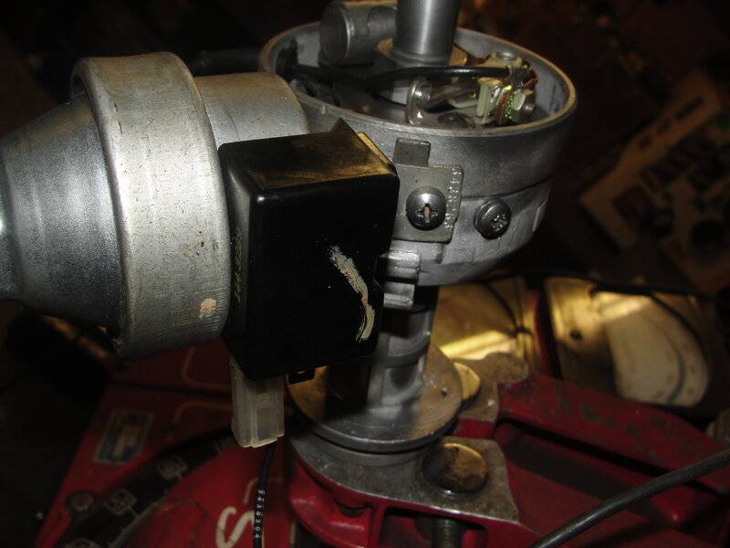

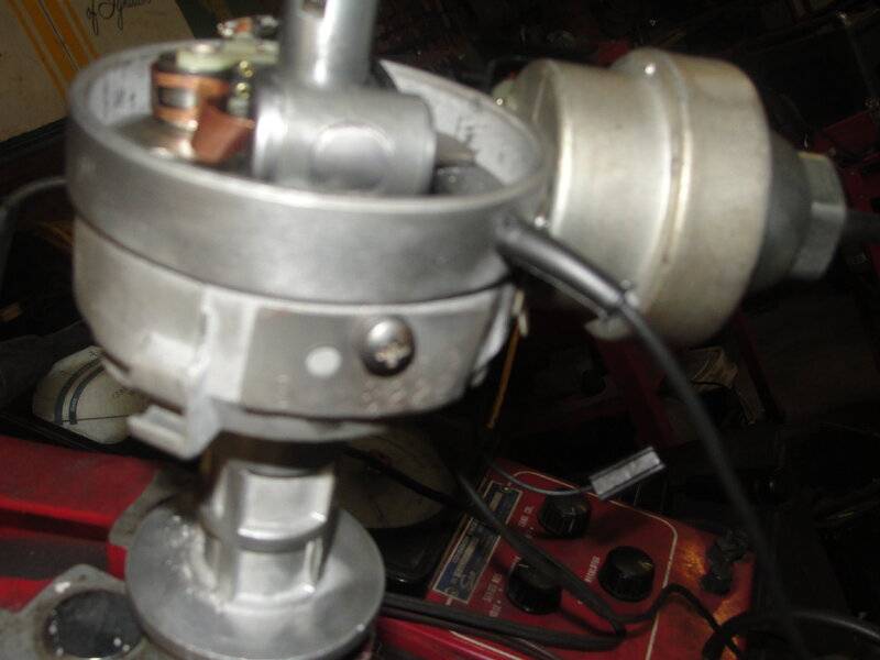

From a parts search. I would go with the FSM. I don't have the Gavin Guliver? Book bet that has it. Average the results?
Thanks Halifax, I believe we have it figured out. You've been a great help on this.
No sweat its all about putting them back on the road!
OK think I figured it out yesterday. The numbers I listed are the assembly and the number on the actual advance and the switching block are different. Just did a 222 that should have a 330 on it and opened a nos box that is a 330 box and you can see that it does not match it is stamped 263! What a PIA this is. I am starting to keep track of them now.
