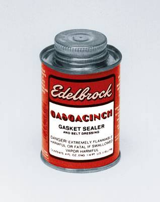

Gaskasinch is what I have used for intakes.
