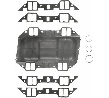

I use the paper gaskets. 2 on each side, under and on top of the valley pan.
I just checked my gaskets and they have the paper only blocking the crossover so is it even worth it?

You can get them together or a la carte. Just the paper gaskets, or just the pan.
They make 2 different pans too. With or without egr blockoff. Just having the paper cover the hole isnt going to block squat.
Ok I guess I will buy another vally pan then. I bought this from jegs and they sold this as a block off but it is only with the paper and not the pan as the holes are punched out. I guess I shold ask if this makes much off a difference being blocked or not. I dont need the crossover so I was just going to block it but if it does not make a big difference then I will just use it. Thanks again for all of the help. Jim

If you already have the valley pan, cut a beer can, block the crossover. As long as the intake runners seal to the head, its good to go. As for the paper gaskets- useless. The factory didn't use them, so unless there is a port mismatch, toss them. Factory also didn't use RTV.....I, (and where I worked as a machinist) put them together dry all the time, with no issues. Just make sure it lines up and seals....
