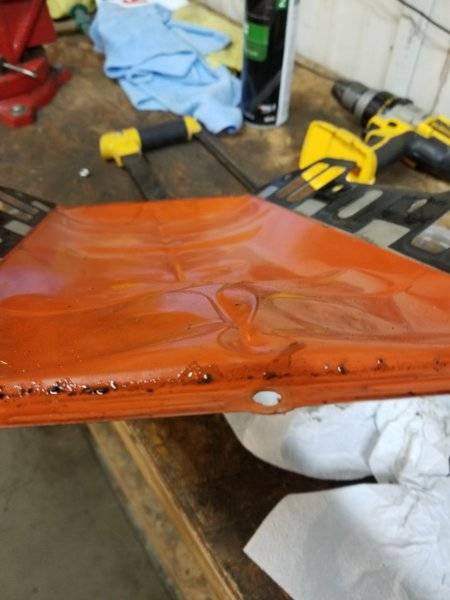

Our 496 stroker motor must have excessive crankcase pressure, as the valley pan has now blown upward against the bottom of the intake manifold. This occurred the last time we raced it. Is this due to blow by past the rings? Or poor venting from the valve covers? It never did this before, and we've raced it lots of times. It has the vac u pan set up, so I don't know what's going on. Will prob pull the motor out soon, and rebuild it over the winter. Has anyone else had this happen?

Better evac system needed or the rings are leaking more. A leak down test will probably show that. Had a small block that wasn't venting good enough and it blew oil out like crazy and it blew out the front and rear intake gaskets....

You have a vacuum pump, and it popped the valley cover? You need to do a leakdown immediately. The pan bent from pressure, but with the vacuum pump you should have had a vacuum (negative pressure) to start with. You might have damage to a piston, not just normal wear. Especially if this was "fine one run" and then "not fine".
I used to put a piston all the way down in a bore, and screw in an old spark plug bottom welded to a quick connect fitting and pull a valve cover. When you hook an air line up directly from your compressor, going from cylinder to cylinder will give you an idea of how bad
the damage is. Just make sure both valves are closed when you're pressurizing each cylinder. WoW! that pic of the valley cover looks just like mine did!
