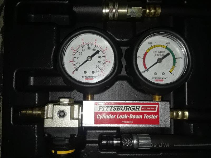

Is it a dual gauge style tester?
If so, let’s see a pic of the gauges?

Yes, it IS a dual gauge set up. From Pittsburgh Tools, Harbor Freight Tools. I could hear it leaking past the rings on every cylinder.
The reason I mentioned it is, I have had numerous people not use that style tester correctly, and end up with poor looking results, only to tear the motor down and find nothing wrong.
My older dual gauge tester has two intentical gauges.
Some of the newer ones I’ve seen have the leak down gauge face where the numbers are backwards.
The needle swung all the way to the right reads “0”.
In order for the leak down percent to be accurate, the inlet pressure gauge must be set so it’s right at 100psi during the test.
When the hose isn’t connected to the engine( no air flowing thru tool), when the inlet pressure gauge is right on 100psi, the leakdown gauge should lined right up with “0” percent leakage.
I know of people using small home compressors that only go to 90psi max, and with the tester hooked up the pressure drops to like 75-80psi.
In that scenario, you cannot not use the reading off the leakdown tester directly.
Yes, this one doesn't seem real accurate. The compressor only went to about 90 pounds. But when it would cycle back on, and the pressure would go up, leakdown would also gradually increase. May take this back, and order one from Summit. I'll try and post a picture of the gauge.

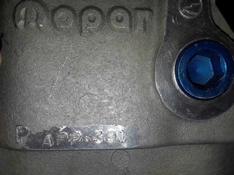

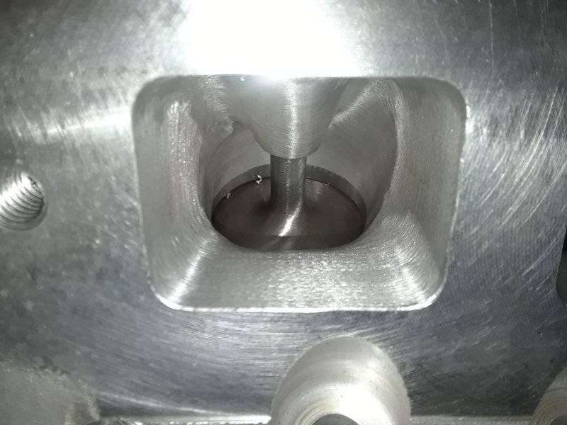

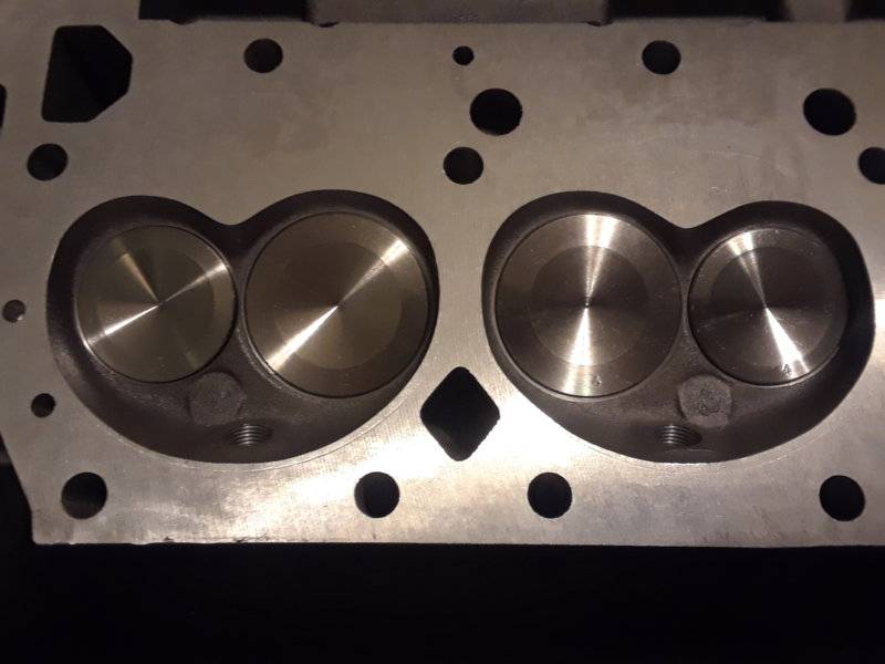

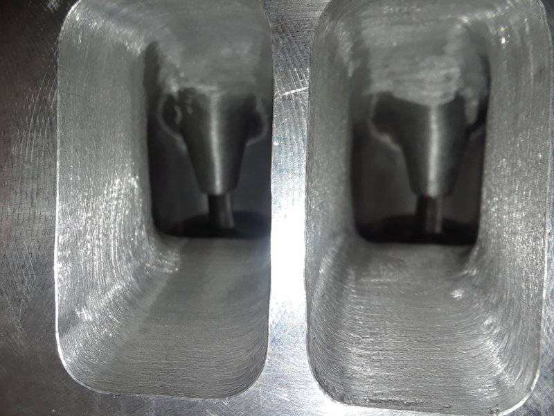

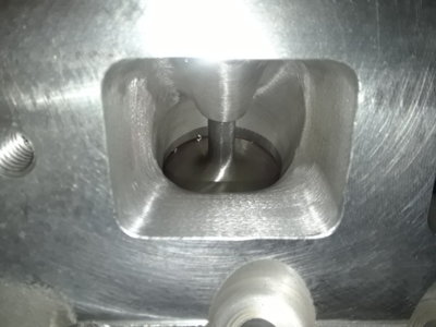

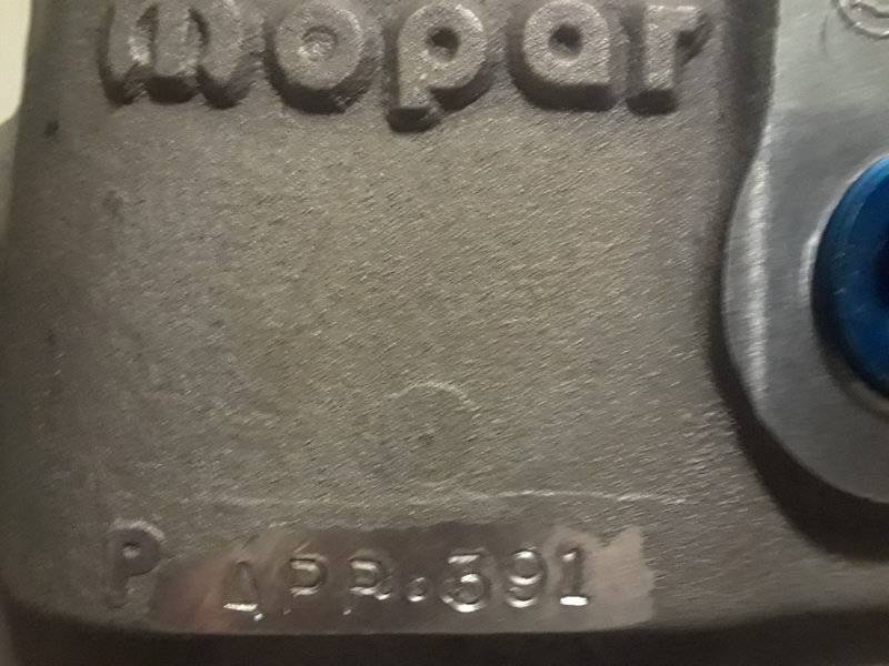

Also, PR heads. What do you think of these Mopar Stage 6 heads? They came with the car, and appear to be CNC ported. I may use these on the build, rather than the Stealth heads the 496 has on it now.
