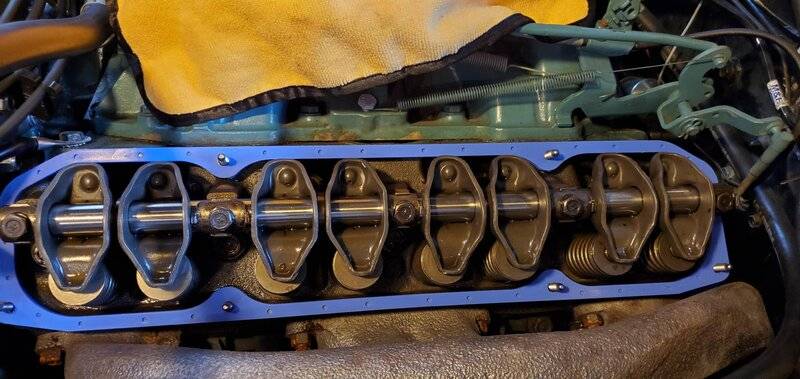

After successfully getting my rear main seal leak free (FINALLY!), I'm focusing on the valve covers. I installed studs an I'm using spreaders. Although the studs were a bit of a PIA (a few of the holes had to really be cleaned up) they make it so much easier to align the gasket. I bought the Moroso 93055 after hearing many positive reviews. I spent 4 hours cleaning off the black RTV off my valve covers that my mechanic used last time on a set of Fel-Pros (?). I tried the Moroso's dry and they immediately leaked on the driver's side firewall in the same place they were leaking before. I'm using a new pair of AMD repro valve covers with a groove around the surface area. I then found info on their website that states:
Moroso Valve Covers Gaskets are not intended to be used on stamped or cast covers with a gasket retention groove. These covers may not allow the gasket to seal properly and will cause leaks.
I know people have used these gaskets dry successfully, but must be using valve covers with a flat surface? The only flat surface valve covers I see are the Mopar Performance and don't seem to be readily available and have mixed reviews. FYI, I have stock heads.
Has anyone used these on oem covers? I have a set of Cometic gaskets on the way to try as well.
Thoughts?

Those blue Moroso gaskets work great where they are intended to be used; that is, aluminum heads and cast fabbed valve covers, both with thick, flat flanges. Used on factory heads, or over tightened, they will definitely split.
My best sealing on factory heads with stock steel valve covers came from using a "THIN" coat of Permatex Ultra Black TRV on both sides of a FelPro cork gasket and snugging up the bolts (or nuts if using studs) with a nut driver. Let them sit overnight. After the first heat/cooling cycle I tightened them a "little" tighter, maybe a 1/4 turn... This all assumes that the gasket sealing ridge on the heads is defect free (no casting bumps or divots) and that the covers are flat with no 'pull down' at the bolt holes. Good luck to all...

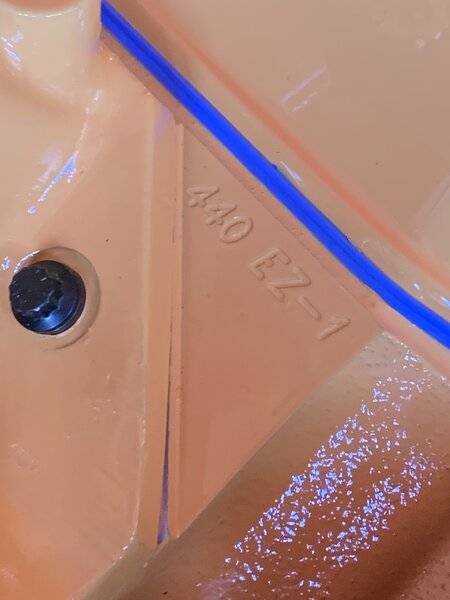

This is what was left on the valve covers once I peeled off the gaskets.
I used brake cleaner to help soften up the residue, but it was a tedious job. It would have been much easier without the ridge around bottom. Whatever sealant was used was a b*tch to get off.
