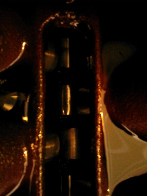

Pulled the intake this morning, and the lobe is smaller by about .120". It has clearly been worn away some. Haven't pulled the lifter yet, but I'm sure it has lost some metal too. All the other lobes look good. Still a mystery as to why this one failed. Here is a pic of the lobe. (center one). Hard to see, but there are a few small grooves/lines on there.
I'm glad I finally figured out how to get pics from my phone over to here. Lol
