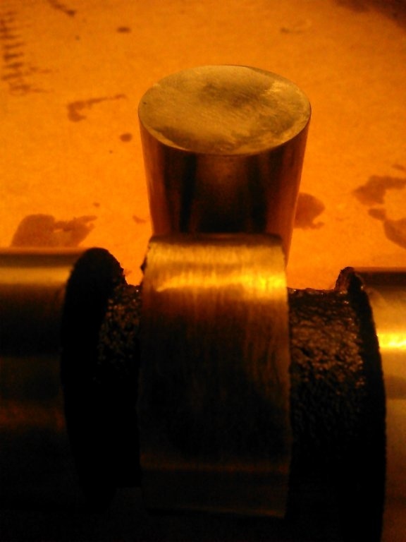

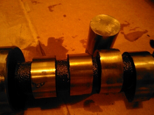

Here are some pics of the offending lobe and lifter. As can be seen, the bad lobe has begun to wear down, but still has some metal left, and the lifter is starting to become dished.
In this picture you can see the base circle on the lobe second to the left, has some pit marks on it. This is prob due to a manufacturing defect. It looks like it may have been that way for awhile. Not new damage.

I don't like how the lobes aren't chamfered or deburred. Those chunks along the edge can come loose and get between the lifter and lobe and there it goes.

That explains why there's not much 'loose' metal floating around. Just got shifted! My guess would be lousy manufacturing, surface treatment. Sad state when lifters bought are pieces of crap out of the box.
You lucked out on that one!!! Agree...you'll get by with just changing out parts, and go for it.

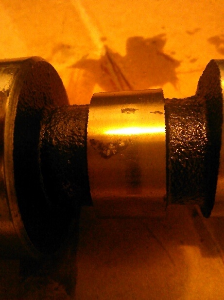

Yea the oil is discolored, but not bad. Can't find any metal fragments or debris anywhere. And there is no ID on the cam other than a number on the back of the rear journal. I think it may be an off brand. Here is a close up of the second lobe to the left of the one that wore down.
Acid/moisture eating in? This thread is fascinating.
