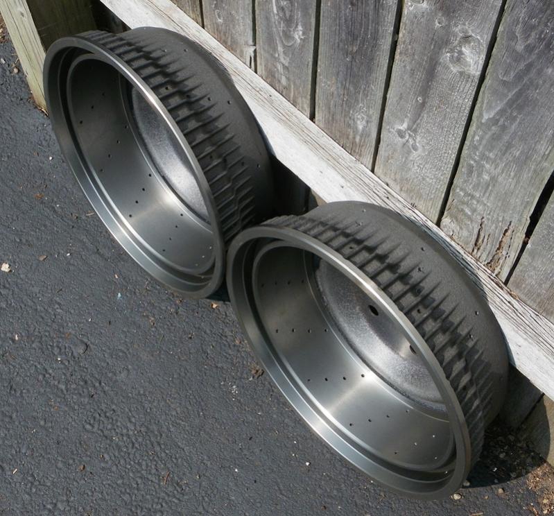

C.H. topping & company out of long beach California for years have performed a service where they drill holes in the friction surface of drums to reduce heat and clear water out of the brakes and perform as good if not better than most factory discs.... I had totally forgotten about this until I began my 10"" to 11" conversion and after searching several forums found this thread about it on for C body's only... I'm going to see what they charge for it but if I remember it was pricy at the time for me ('91) but I was in college then... any ways some others on here may be interested

A great idea. And before that, some racers were drilling their brake shoes to help vent the gasses too.
I showed this to one of my mechanic mates who is a top machinist, we are going to give this a go..Will do it over winter though. So will report back some time in the future.

I'm partial to my 11 inch "death brakes", I just avoid driving in the rain and keep away from standing water. I am going to send a set of drums to them and see how they perform. Thanks for the info!

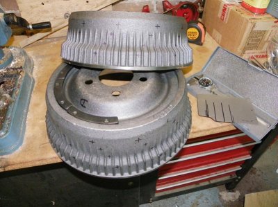

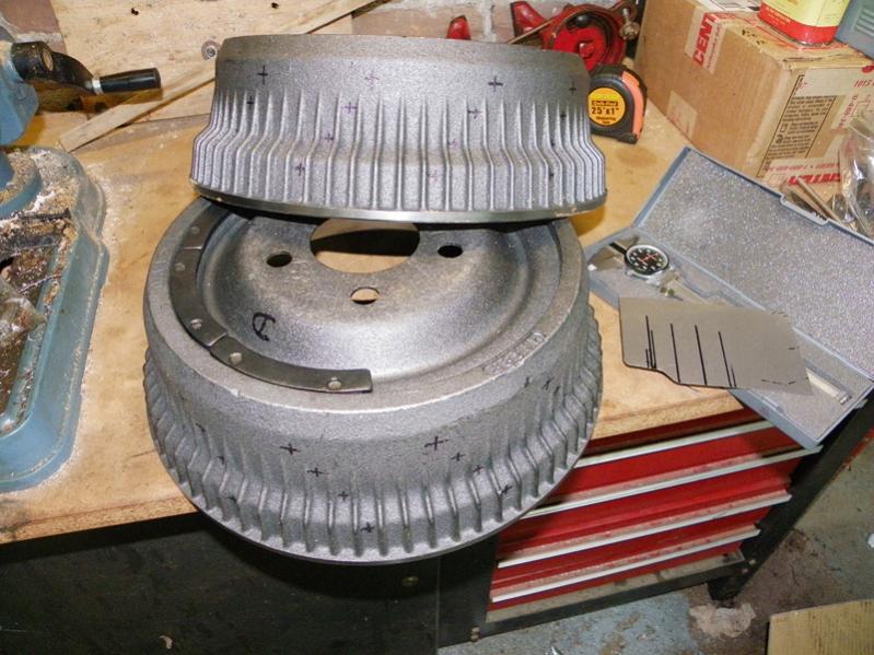

I used a drill press to drill the drums.
I can't say if you can still buy them ready made, but I know at one time you could... Several race performance shops carried them, but they are/were VERY expensive. Cheaper to buy drums and have them drilled than it was to buy them ready made. You don't need a full machine shop to do this. If you have a large bench top or stand alone drill press you can do it yourself. It's not quite as easy as they make it sound in the link below, but it's not difficult to do either... you just need a couple of very exacting measurements to start, make a jig, and your off. It takes maybe an hour or so to do and your done.

That's great once the jig is made you're in business.... I would use new drums and wrapping some springs around the out side will help with dissipating heat like on the factory smooth drums... I would also reline the shoes with 'green grabber' the material they use on big truck drums.... with 'Earls' flexible brake lines and a 15/16 master cylinder bore.... should want to put you through the windshield... I started out with a disc brake conversion gone wrong by a PO and have come up with this as the best brakes... disc or drum....

How did you make sure the drums were still balanced? Did you do that afterwards? And if so, HOW?
There is a way to balance the entire wheel assembly... in the old days you would spin up the wheels and tires on the car with an electric motor with a steel drum and chalk Mark on the tire the ballancer had a strobe light with a magnet on the chassis... similar to a timing light and you would put weights on and keep spinning it up till the strobe verified it was balanced.... a bubble ballancer would be another way with the rim and drum bolted together.... I wouldn't think that the holes evenly placed around the drum would pull it out of ballance any... some would have the tires shaved down evenly to make the perfectly round also... but mostly on 200+ mph salt flat racing would you ever notice a vibration.... you could add calcium to the tires and they will ballance out on there own above 60mph like in big truck tires or in any combination of the above to get to a perfect ballance.... if I were a perfectionist I would have to go through 100's of drums and 1000's of tires to find 4 that -0- out perfectly with little to no weight or holes drilled..... the nut shell on balance
