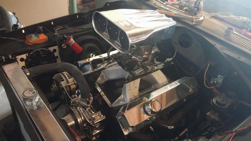

Takes 5 or more starts to even begin idling without me goossing the throttle...
440, roller motor, Holley 750 no choke, 2 speed Holley blue pump, 9.5 compression. Have not put the timing light on it.
Is it the carb tuning, electric fuel pump or timing?

well,with no choke you may have to feather it a bit to keep it idling on its own.how big is the cam and what is your idle speed set at?i have no choke,huge cam,and strait through intake.takes a couple tries to idle on its own.open plenum intakes are very cold blooded,depending on your set up. 10411292_237489503112653_6391885681296785854_n.jpg

at about 60 degrees outside it is very cold blooded.starts after about 3 pumps of pedal,but need to feather it for about a minute or so.then need to let it warm up for a good 3 to 4 minutes or will try to stall when i hit the gas.alot depends on how big the cam is.i have advanced about 20 degrees initial time because the cam is so big.

To answer the original question: it is almost undoubtedly the lack of choke. Alternatively, you could run it very, very rich. So rich that it could (perhaps) overheat the exhaust once it warmed up. Not a great idea. Why no choke? They serve a purpose. Adjusted well, they are worth the effort.
Fine tuning either carb, or timing is normally done after engine is at operating temp.
But, without a choke, only thing you can do is maybe 'slightly' richen the mixture, to help the cold start. Saying richen both mixture screws, 1/8 of a turn out, to see if it helps. Still going to be nature of the beast. Even after doing fine tuning while warmed up, used to set mixture dead on, and add slight richened adjustment to help the cold start.
I've opened both screws to 1.5 turns out from where they were at 1, seems to fire up easier but still working on that idle..
Perhaps barometric pressure and temp have something to do with this, the car came from Wisconsin.
