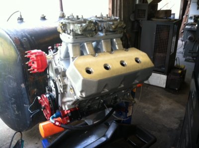

Since I spent over $115,000 in 1.5 years with Vignogna Racing Engines(Jimi Vignogna) from Wappingers Falls, NY on 4 engines and he basically ruined my 2015 season due to poor careless, shoddy work, I need to let everyone know to stay far away from this hacker.
1st Hemi was a KB block Stage V big valve headed 604 CI which he has no clue on what to do with it. He put the wrong head gaskets on it and assembled it running it on the his infamous run stand which made a green pea milk shake out of it.
So after I call Ken Black, KB says you need a special Cometics head gasket designed for our block. Vignogna never did any research on doing a high end engine like this. So Vignogna doesn't take any responsibility on ruining a perfectly good set of head gaskets so who do you think buys the new set of Cometics, Yep me. $220.00 later. Fast forward 2 passes later and the motor lets loose due to no oil pressure because he put in the wrong distributor shaft which did not engage the oil pump deep enough. Bearings seized on the crank and block was never honed correctly or even done because the cylinders were egg shaped and wiped out my rings and scuffed my $$$$ CP pistons. CP specifically also stated to clay all 8 pistons due to the very high compression. Vignogna didn't clay any.

Who assembles a engine no matter if it's a $4000.00 wedge or a $50,000 aluminum hemi next to a lathe and a Bridgeport. re was metal shavings all over and inside of my tunnel ram intake and dual edelbrock carbs. My air bleeds and boosters were clogged with dirt and dust.
My new MSD crank trigger, NGK spark plugs, gaskets all disappeared and all of my ARP oil pan studs and nuts were missing off my engine. Those cost $109.00 alone plus 3/4 of my jesel belt drive allen bolts not on the engine when I received it back.

The hemi was crated and shipped out about 5 weeks ago. It's all finished and waiting on the new CFE Sheetmetal intake. Then it goes on one of their 3 dynos. They said it wont come back till its perfect. Going to try 2 sets of carbs on it and I will get a build sheet and dyno sheet.
I'm only surrounding myself with quality professional builders from now on. Vignogna was close and he fed me some great lines in the beginning to hook me in. I'm the *** that gave him 4 engines to do. Leaving 3 of them up there all at once was a huge mistake. I should have learned my lesson back in 1998. He ripped e off back then too. But he promised to make it up to me. He sure did. $12,000.00 to fix 2 engines and who knows how much the wedge is going to cost to get that fixed.
No more part time/backyard mechanics with iffy equipment.
It sure looked good on the engine stand.
