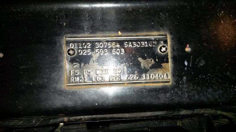

Ok I bought a 69 rr knowing its not number matching. However the fender tag on this car is not decodable. After several websites I cant find anything. Vin tag shows lynch road Michigan, roadrunner. Im trying to find the original color of the car. Anyone know anything about the tags.

I thing the fender tag is bogus
I think ALL Roadrunners should have a VIN with the RM21 or RM23
Hang on;
-Found this: "In 1969 it's hard to tell a counterfeit because the VIN wasn't keyed to the body numbers."
-I don't see any visual cues leading to an anomaly, it looks OK so far...
Hang on;
So, we know that the "Lynch Road" plant fender tag is somewhat unique compared to other 1969 Tags. The bottom row, to the left, has the 4-character car line and model code (same as the V.I.N first 4) followed by a 3-character engine code. These are followed by a 2-character transmission code, then the 3-digit build date and vehicle order number.
The 2nd line from the bottom starts with the exterior color F5 followed by a 3 character interior code and a 2-character upper interior door code.
RM21: Roadrunner 1968 (21 denotes 2-door sedan or POST, 23 denotes 2-door coupe)
E63: 383 CI / 335HP engine
F5 F5 : Color Codes (Grn/Grn)
M2X: Interior code
X9: Upper door paint
2nd row from top:
925: Engine=925 engine assembly code = 383-4bbl HP 335 horse painted orange for installation in a B body with a manual transmission
593: Axle=593" is a 3:23 single track rear. It is a non-sure-grip unit
603: 603 = transmission part number = four speed manual transmission behind a 383
So, I hope this help you out!
It looks good to me!
Green/green (top, 383CI 335HP (painted orange) 4-speed 2-door sedan Roadrunner with a 3:23-1 Non Sure-Grip rear end, painted upper door (interior) panels built at the Lynch road assembly plant June 26th, 1969.Cool car!
this is the fender tag
vin on dash checks out ok
M2X:
X9:
Check my post (Post #8)
I've completed the de-coding...
It all looks great to me...except for the bottom row 626? I think its the build date?
Any help?
