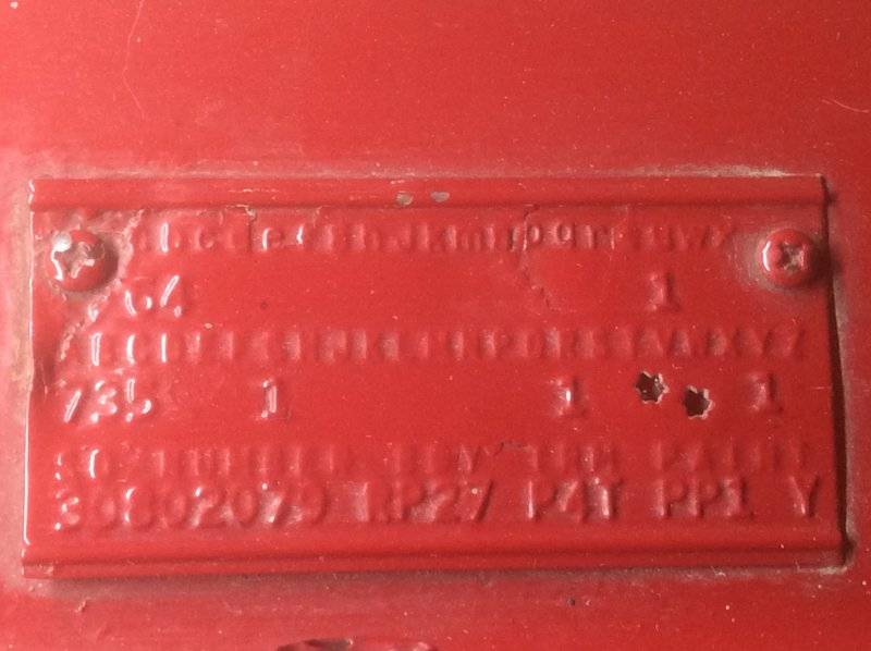

The fender tag engine size should agree with the VIN.
That's a start.
But, no only VIN is on the VIN tag.

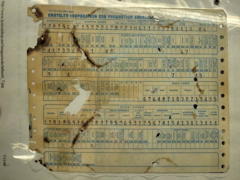

Buildsheet has one.
The only two ways you'd know if you have the correcdt VIN tag...
Example.. I can't find where I stored mine for the '66 right now.

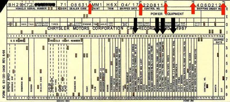

Long shot.... look at the rad support, engine side , near the battery tray for a cert card holder.
May get lucky and gave one still stuck in there.
Three ways! Forgot about the card as well. Have mine for the '66 HP2 and Wife's '67 Formula S

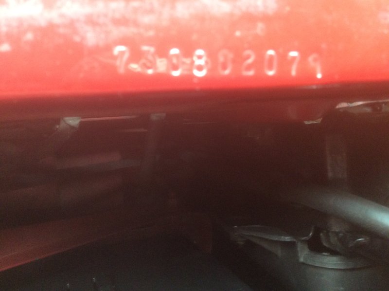

If you have an anti freeze sticker on drivers side before go down, on radiator support, remove it. There are numbers some numbers will be on fender tag. Look at lower left corner for SO the numbers on radiator should be there. Maybe only last 4 or 5.
