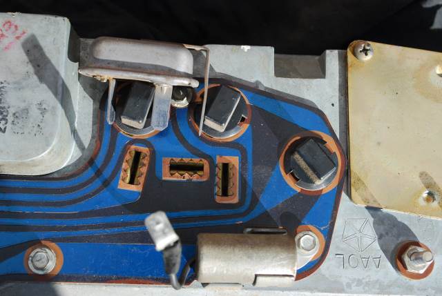

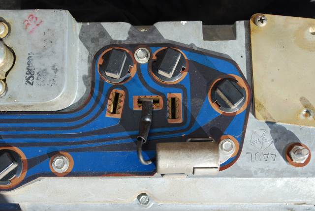

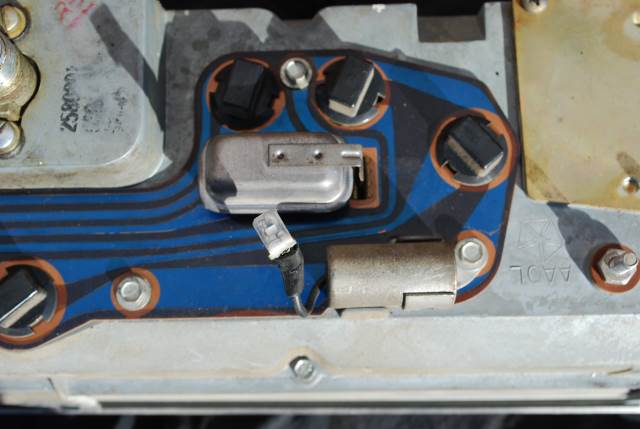

Ok, so I unplugged stuff from under my dash this morning to diagnose why me blower motor wasn't working. one thing I unplugged was this: DSC_7912.jpgDSC_7913.jpgDSC_7914.jpg I think that is the voltage reducer bit I'm not sure where the condenser looking thing attaches. Is that where it goes?
Yes, it is the voltage regulator. Best to replace with a modern solid state device.
Will it also do away with the condenser looking thing with the wire also? Never mind, I found out what it was.
That is your noise reducer, if you don't want it take it off. Why are you taking your dash apart for a blower motor issue?
