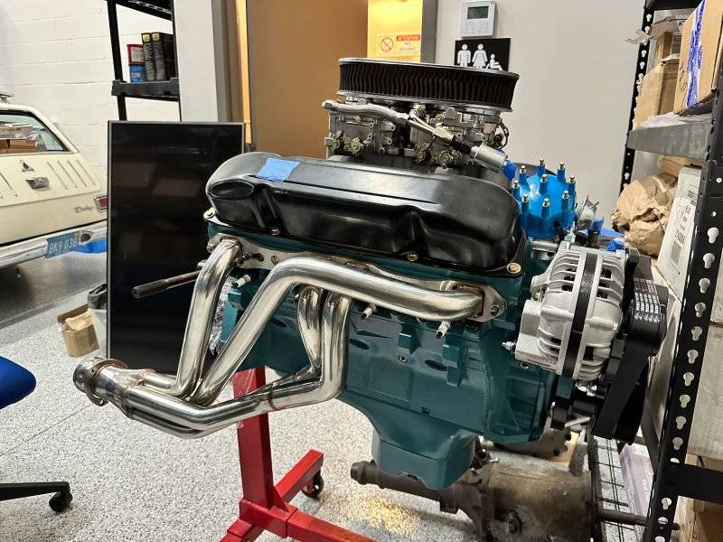

Bit of progress over the last week. I hung the stainless headers on the 440, mostly to get them out of my shed, and to build some more excitement. Not sure if I mentioned this previously, but the motor took a tumble while being transported from one shop to the other. Dented one of the valve covers and broke two spark plugs, but that was it thankfully! The floor of the Uhaul truck was less lucky... Replaced the plugs already, and found a good deal on a set of M/T valve covers here locally.

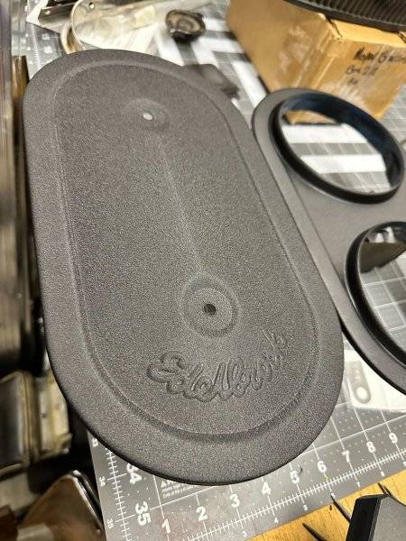

I had never used a wrinkle paint before, but I am very pleased with the result on this! Not bad for my first time. I also picked up a new filter for the air cleaner, as the old one was crushed a bit when I got it, and had seen quite a bit of life. I'll share pics of the valve covers soon, they needed a bit more prep and I am almost done there. After having fun with nice clean looking parts, I got back onto pulling Voodoos interior. This was the first dive into the car, still full of barn debris, trash and a few gems.

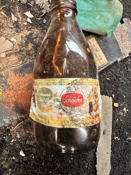

Found a Schaefer beer bottle under the seat, along with an old style beer can, and several bottle caps. All Schaefer, this guy was loyal, and liked his road sodas haha. Definitely tracks with a car last used in 1977. I poked around and found a few old coins, tons of pens and pencils, and some other odds and ends. Then I saw something wedged down the side of the passenger seat.

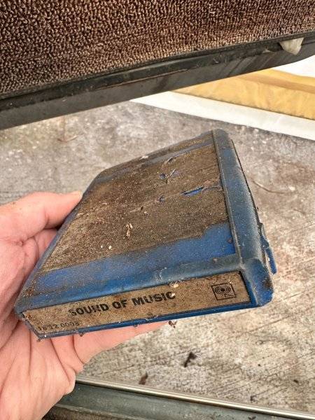

I was excited to find an 8 track, but "The Sound of Music" was not what I'd have expected to find all things considered haha. On the recommendation of someone (I forget if it was on here, or on social media) I checked under the back seat. Lo and behold, the broadcast sheet is there!! It is definitely super delicate and already torn in several places. I took photos to try and capture the information the best I can. I am leaving it be until I can get some professional help removing it. Likely from the interior shop.

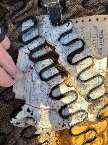

I don't know much about broadcast sheets, other than it's cool and a good sign of originality in a car. If anyone can read this sheet and discern anything neat from it, I would love to know more! Anyway, going to be stripping more of the interior soon. I think I found a local who can assist me with the floor pan for a fair price, which is super exciting. Once I get past that hurdle, I am 100% in my element and I can go pedal to the metal. Thanks for tuning in!

Made a little more progress yesterday, managed to do the wrinkle finish on the Mickey Thompson valve covers. Just need to get them baked up for the final cure, and they are ready to go on. These definitely took a bit longer to establish a decent wrinkle. The pic below is from last night, I checked them this morning and they look even better. The tiny bit of remaining sheen you can see in the pic is now gone. Hoping this weekend I can get the family together and get aggressive with the teardown on the interior!

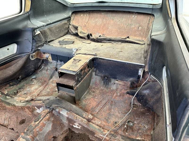

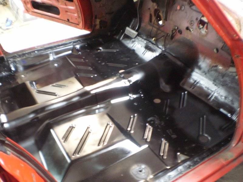

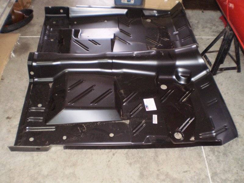

BIG progress today! Major thanks to my dad and brother for helping me for a few hours. Got the majority of the floor-relevant interior removed so now you guys get to see the full glory of the floor pans, or lack thereof haha. As I noted before, this was fully disclosed before I bought the car, and it is actually relieving having it apart and understanding the full scope of what is needed.
If I am lucky, I can get away with a full front pan, and the two "Rear Footwell Area" pans from AMD. I already have the shifter bump out ironically, it was a birthday present back when I planned on manual swapping the other car! I'm going to poke around in the rear under-seat area and make sure that rust is surface only. Really hoping there's no structural issues in that area, as that's the most expensive part of all. I am thinking I may give the removal of the old pan a try, as that was a decent chunk of the labor quote. After removing the rest of the interior panels, I am going to have the welder come by and weld in the cross bracing. I want to make sure the car is solid before I remove anything more than nature already has. The doors close great on this thing, don't want to mess that up!
I also dropped the valve covers on the engine, mostly to store them, but it is definitely nice seeing them in-situ. I am really happy with the wrinkle finish. I need some longer as these are thicker cast aluminum covers vs the stamped steel I pulled off. Also need to source some breathers and fill caps. I got the shipping confirmation for the repro hemi/six pack style air cleaner I mentioned in the post before this one. I really wish I had more of the VHT paint the motor was done in, but sadly I don't and it has been discontinued for a while now. I think I may do the lid in wrinkle black for now to match the valve covers.

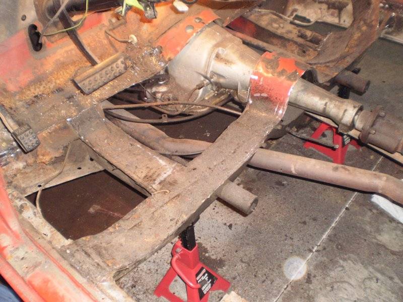

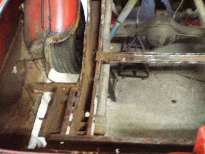

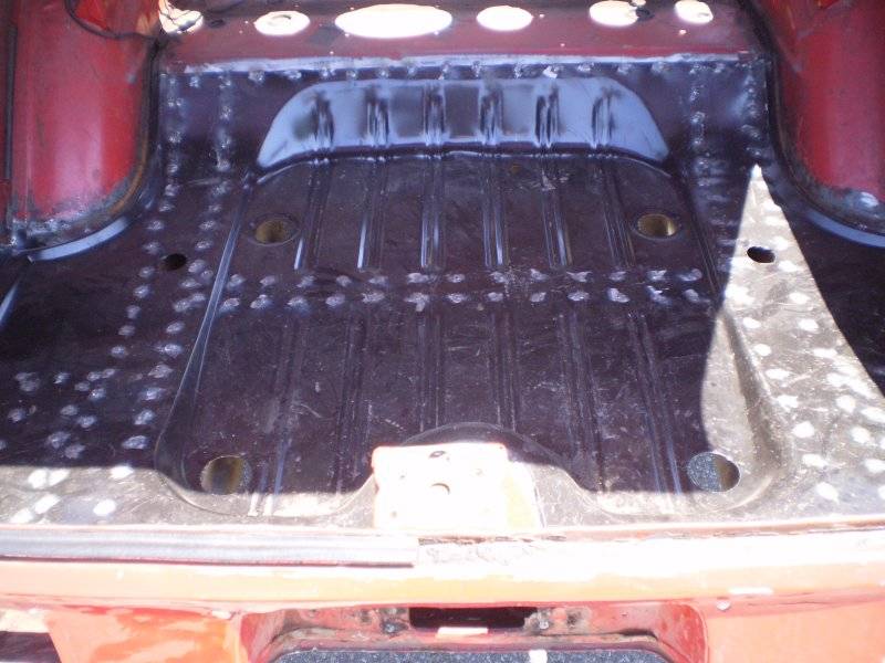

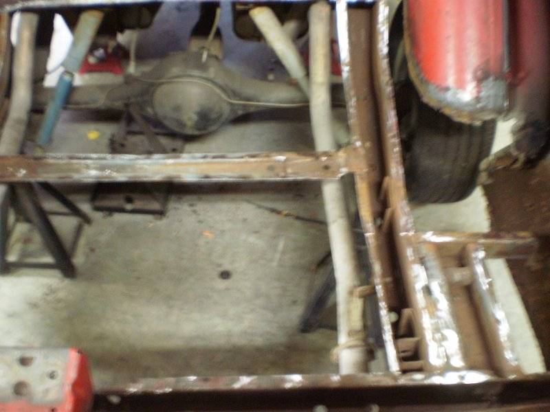

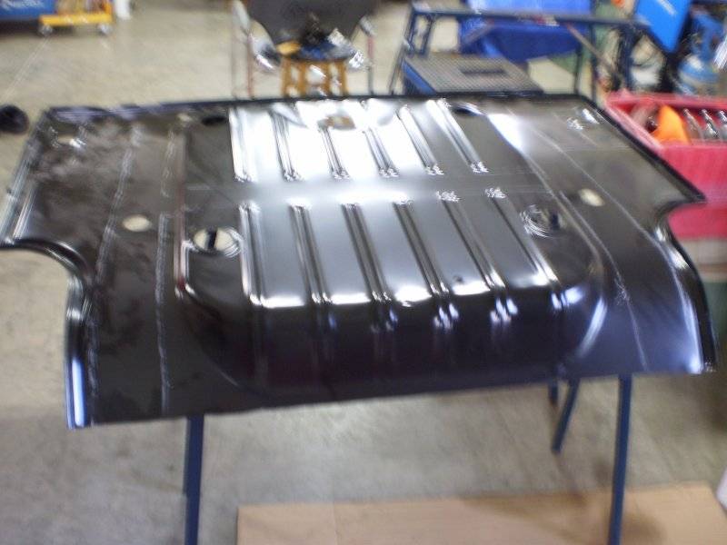

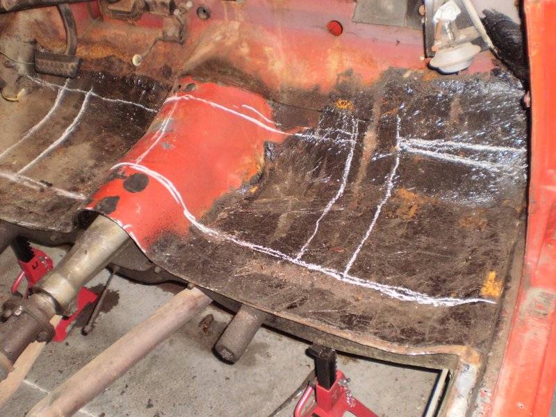

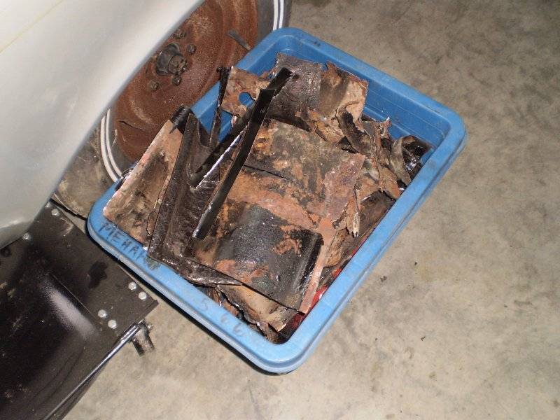

I had to replace the front floor pan and trunk floor in my '64 Polara. I removed the old floors by carefully marking out where the crossmembers were with chalk and cut the bad stuff out with a cutoff wheel. Then, I removed the spot welds on the crossmembers with spot welds cutters. I bought replacement AMD floors, and paid a friend of mine who knew what he was doing to weld them in for me. At the same time, I bought subframe connectors, and had them welded to the floors and subframes. My old front floor s in the blue recycle bin. LOL

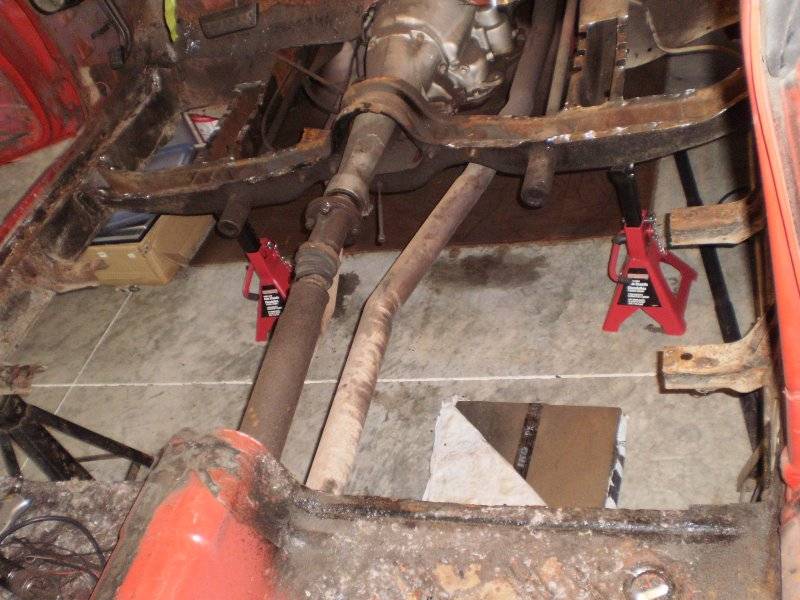

Before you cut out your floors, make sure your car is supported well at critical points. I had about a dozen jack stands under my Polara.
With the floors looking like that I'm a bit worried about the torsion bars cross member.
I suggest you take a close look at it.
These photos are SUPER helpful! Thank you so much for sharing. My preliminary checks haven't turned up any scary failures in the structural supports under the pan, so I might be able to get away with this approach without added bracing. As you noted, definitely will be thorough in supporting the car.
