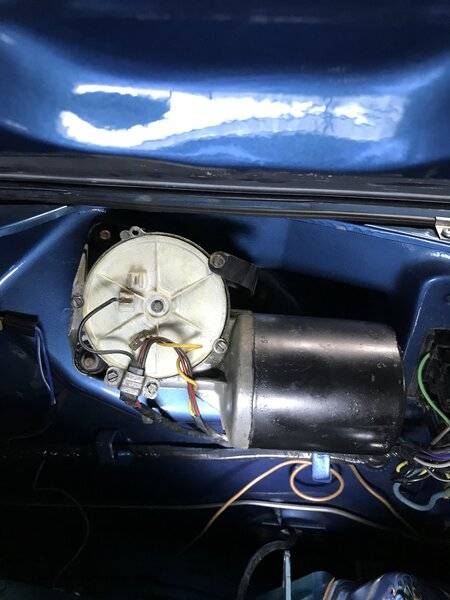

Can anyone identify this wiper motor, not much info on it , but it came with car , prior to restoration! Thanks for any help! Installed on 67 Gtx 440
Looks like one version of the variable speed motor. Does it have a part number on the black part? I just sent a 2580915 variable speed motor for restoration. On your wiper switch, how does it operate. One click and then some free space to turn maybe another 1/2 turn, or 2 definite clicks?

It’s still mounted so number is not clear, but switch has off and two definite clicks and under the plastic gearbox cover is a set of points that I believe activate the park

Looks as though the number is 2877963

Looks like the 2-speed wiper motor on both my hardtops. My convertible has the variable speed and it has a different plate where the wires connect.
Off and two more definite clicks sounds like a 3 speed. Off and one more definite click is a two speed.

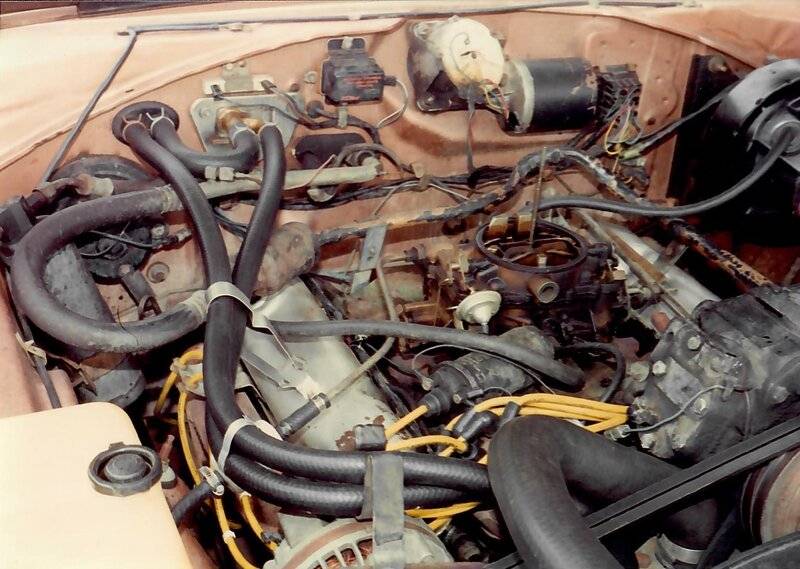

Here is an old photo from the teardown. I can get a closer photo when I get home in an hour or so...
