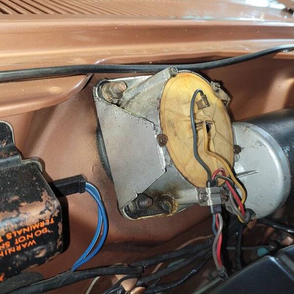

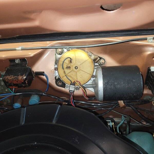

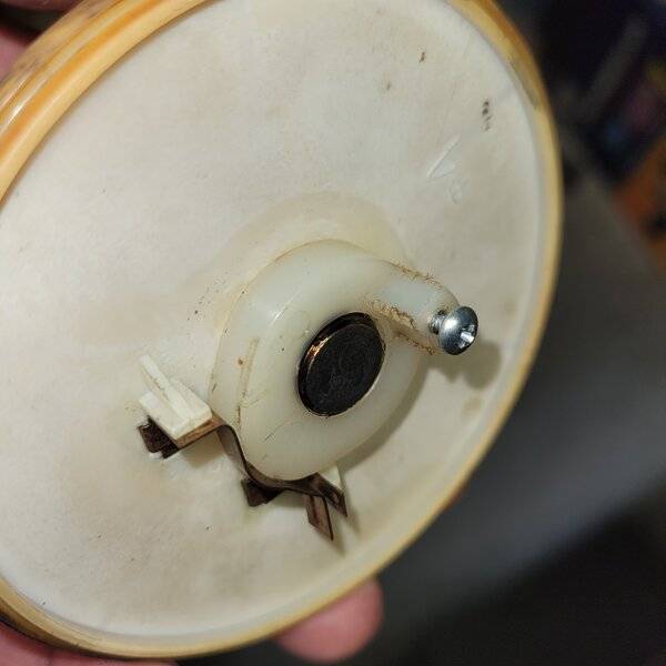

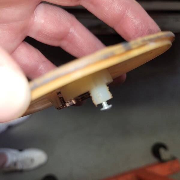

Here are some closer pics of the motor. Let me know if you need different views. Also, pics of how I repaired the park cam when it stopped making contact with the drive gear - I thought I had glued a piece on, but now remember that I couldn't get it to stick so put a small screw in the arm to extend it.
