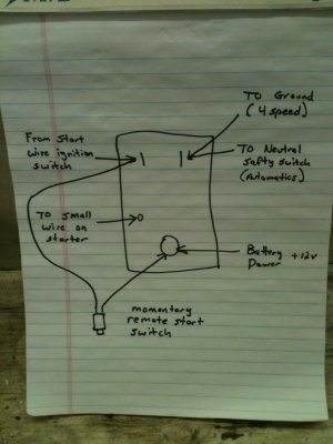

thanks, i really would like that schematic if you can email me one to [email protected] or post it up on here would be great. thanks for spending time writing this out for me.
attached a pic of schematic i drew up for you. hope it helps. if you use a ford syle relay make sure you get the 4 wire not the 3 (the 3 wire ones ground through the mount) if you need a neutral saftey. will hook up the same battery + and wire to starter go on the 2 big side lugs and wire from ignition and wire to neutral safty go on 2 small front lugs
thanks for the schematic. it seems as though 65 starter relays are patterned differently than 70 relays.
i had to go to the stud and the spade right above it. the spade you show is for nuetral safety switch on mine. i got it all wired up and it works great. 2 remote starter buttons 1 on each corner. it came out great. thx for your help.

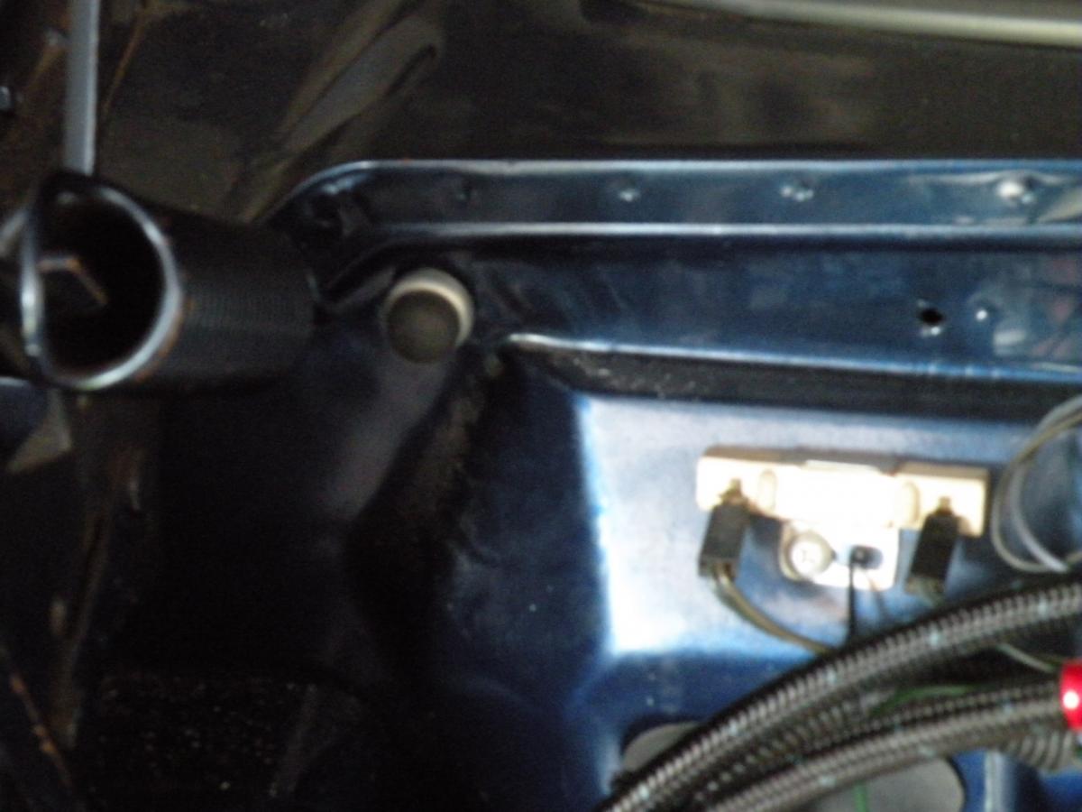

ill post pictures to show my 65 relay.
this will work for now until i wire up my napa echlin st85 ford style solenoid.

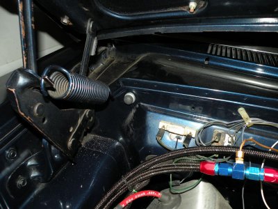

HERES where i put my remote starter buttons so i can adjust my valves.

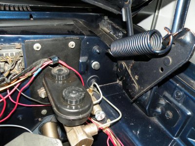

I did a temporary setup through my stock relay.
it works but going to remove all wiring from engine bay and rewire through napa echlin relay solenoid st 85 and send everything through the solenoid nice and neat.
only thing i want to keep is my key on/off and headlights/taillights/turn signal
