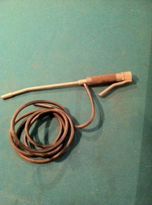

This is a great tool for cleaning parts & the engine bay.Hook it up to an air supply & fluid. I Fill a gallon container with part simple green & palmolive dish detergent ,water, customized to suite your needs. The combination of compressed air & fluid slowly applying to area's .Great degreasing......
