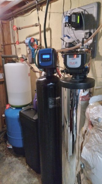

I switched from a salt regen water softener to a hydrogen peroxide injection system with charcoal filtration bed. It got rid of all rust and sulphur smell. Now, my blond wife won’t complain that the well water is turning her hair strawberry blonde.

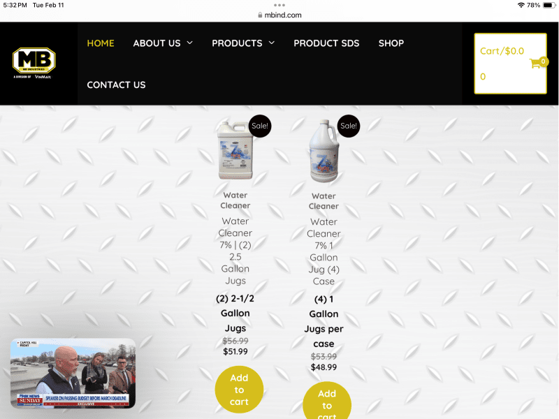

Yes, I’d say about one gallon per month. I buy direct from a wholesaler for $10 per gallon (5 gallons per shipment MB Industries - MB Industries Store | BOV Bottling| MB Industries). But using the salt/softener, my wife’s hair turns strawberry blonde and I never hear the end of that. Plus, the salt/softener left some rust get through and a lot of sulphur smell too. The H2O2 gets rid of everything.

I see. Well, sounds like a neat setup. I would consider it just for the fact of not having to lug 40# bags of salt around. Just a couple of months ago I hurt my back doing just that. Unfortunately I don’t think i would have enough room in my pump house for installation. Also I read that the H2O2 has a short shelf life, and I like to stock up for end times. Sulfur smell isn’t an issue with my well water. The sulfur smell is from hydrogen sulfide gas caused by bacteria growth. The charcoal media you are using is effective for filtering that out. It’s a cool system you have there, I didn’t know they made Harry home owner versions.

Cramped quarters for my system, as I left the water softener in place (I use it when filling the pool).
