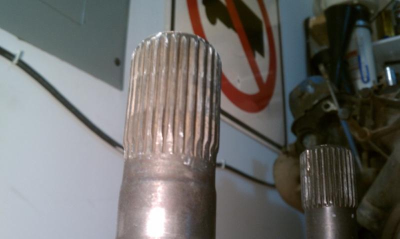

My axle shafts look the same. In the picture below, you can also see my old shaft on the right, which had shorter splines, the ones in am installing are from a 71, my old ones are from my 73, and you can see why i replaced them, broken spline.
