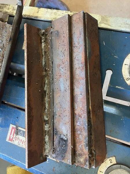

Old cars with crash damage or rust will need repair. You can get on the list and wait your turn or find a way to do it yourself. There are numerous times that having a welder here has saved me money. For almost 30 years, I’ve only done MIG welding. Most automotive stuff can be done with the MIG. I’m not a great welder but I do okay. This past month I started a welding class with another FABO member. This week we did some stick welding, a type that in my opinion, is obsolete for what kind of stuff that I do. I took the class to improve my MIG skills but this class is geared to exposing students to all the common welding techniques. SMAW, GMAW and even TIG. My skills at stick/arc welding are not good but improving. It was so frustrating , I would have quit but I heard that next week (week six of eight) we focus on MIG! The first four weeks were spent learning terminology, symbols, techniques and fabrication. They had us build mini-Hibachi grilles….
They had “plans” we had to follow to cut and shape the sheet metal. The designs of the bases were up to each student to come up with.
That was fun. The welding booths there were often busy so I MIG’d them together at home.

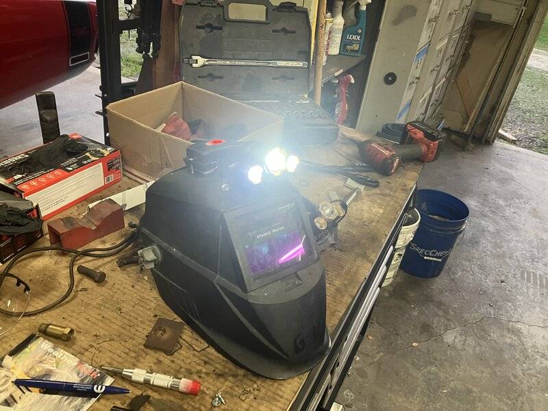

I stopped at the local welding supply to see about a welding hood mounted light. They had nothing. At home, I made this:
It is fairly simple. Back when I was still working in construction, we often started work before sunrise and needed light to see and work. We al started wearing those LED lights attached to an elastic band with power supplied by rechargeable batteries. I just cut the bands off and screwed it to the hood…
Once welding starts, the lens darkens for protection but before and after, a dim area makes it hard to know where to get started.

I've noticed that even with the auto-darkening, my eyes have to adjust to the light conditions...before, during the weld and after. Low light makes it really difficult.
You can get these lamps on Amazon for around $20. They really are bright enough to work in the dark.
Rechargeable batteries are great for something like this. You could make brackets to hold a standard flashlight to the helmet, some are lightweight so you may not even notice the added weight.

Talk about timing. This afternoon I was welding in a little plate to fill where someone had cut a hole in the kick panel area for a speaker. I couldn't see crap so I had to move the car and close the shop doors because of glare. Still couldn't see crap so I got my ryobi free standing shop light and put it behind me, slightly off to the side, and could see a little better when my reading glasses weren't fogging up. Then had issues with the dimming happening a second to slow so I had the green blob in the center of my vision when I was trying to do a series of tack welds. I just texted a friend telling him that I am going to the welding supply shop tomorrow and getting a "good" helmet. Maybe with built in magnifying lens. Never occurred to me that a light on the helmet, aimed at where I was looking, might be really useful.

Seeing what your doing is of upmost importance. Lots of auto darkening helmets have light adjustments from darker to lighter, depending on your eyes. Also if you wear prescription glasses you might want to try taking them off when using your helmet. Some people have to use a magnifying lense to see better. You have to figure out what works for you to be able to see a clear picture of what's going on in the puddle.

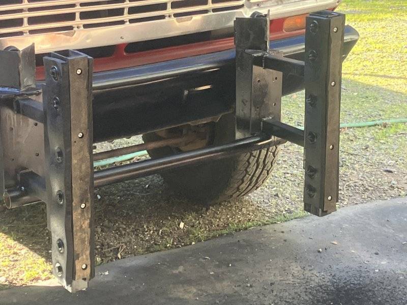

I made a CHP/State Trooper type of push bar for my work truck...
I wear contact lenses but need 1.50 cheaters for up close stuff. I do have "diopter" lenses to put on the inside of the hood.
