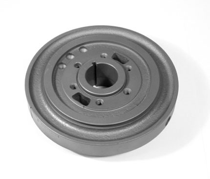

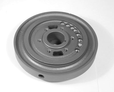

First picture is '62-'71 part #2658457
Second picture is '72-'75 part #3614371
You have one of the two, probably the second one, but in any case it's the forged crank, (internally balanced) They were both used on the forged crank.
The thing you might want to check is your origanal pully's bolt hole pattern. The earlier dampner had an offset pattern, only bolts on one way. The later dampner, '72 and up, had a symmetrical bolt pattern, (doesn't matter where it bolts).

Thanks, my friend. Yep, I was perusing that site last night, then had a thought:
Is it possible to install a balancer for a forged crank onto a cast one?
Yes you can. But in your case it is highly unlikely. The seller had it in the car and it was running. He didn't state that he was having a vibration he couldn't find, did he?
