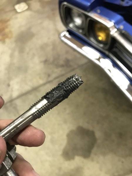

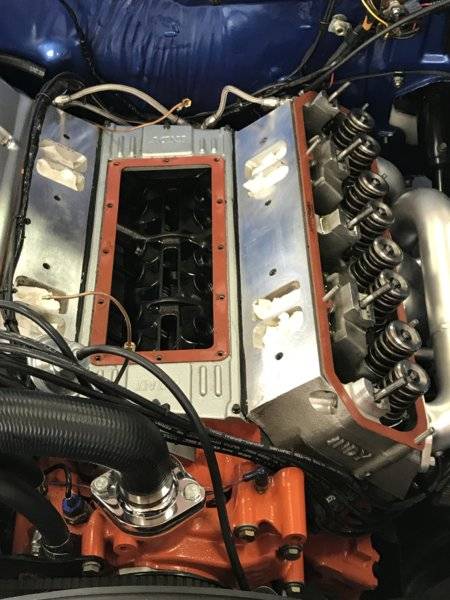

I put a longer throttle cable on the other day so I could try a taller carb spacer. Thought I had a bracket I could modify for the cable, in doing some fitting up, I pulled the threads in the rear drivers head. Awesome, helicoil job on the car.. sometimes simple **** isn't so simple

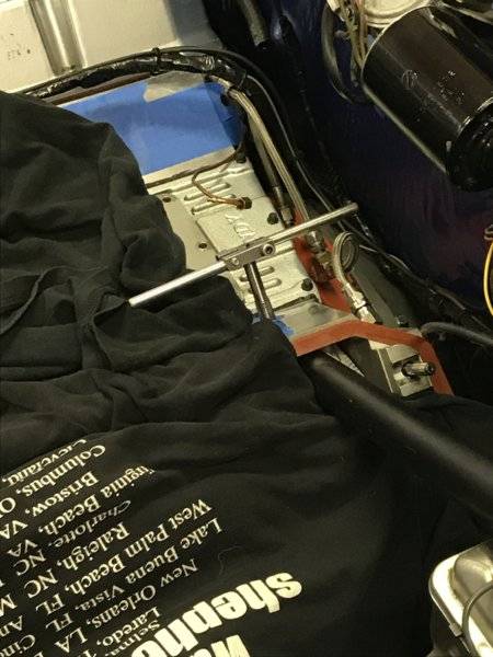

Pulled some parts off

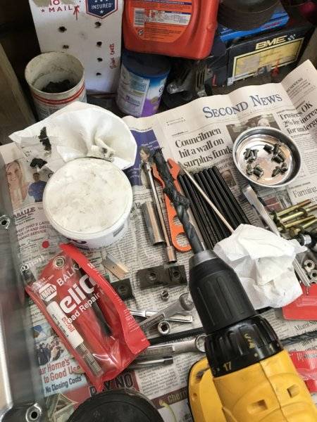

Lots of protection

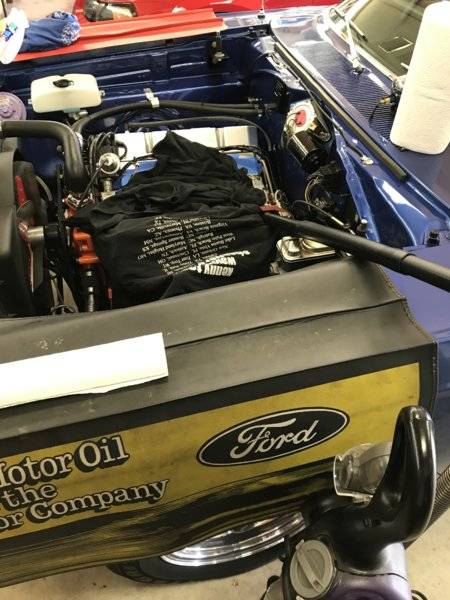

Vacuum too, better safe than sorry
Lots of grease!!

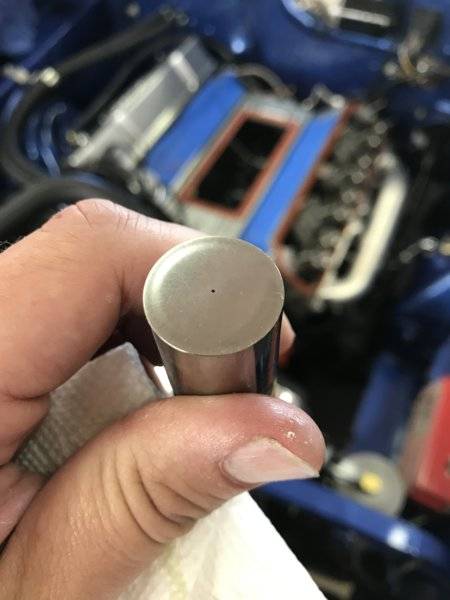

May as well check the lifters while it's this far apart. Look good, they are all spinning. I do see some signs of wear though. Guess a roller cam of sorts is in my future.

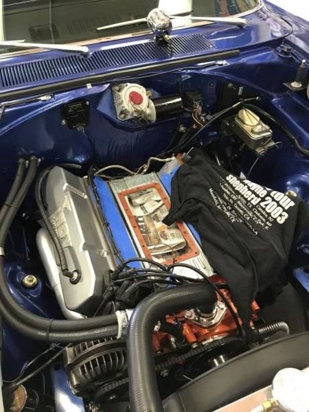

And back together with that pesky 2" spacer. Simple enough, eh? Sigh..
Some wear? That lifter already has a hole worn through the bottom. Must leak oil pressure. How was the cam lobe?
I think the problem started with that drivers side fender cover LOL. Some days it just doesn't pay to start anything.
Gotta take it easy on dem alloy parts....
