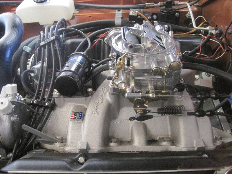

Went back to a carb

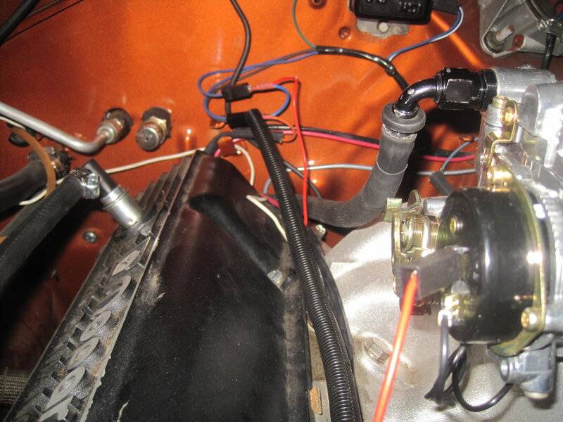

Just checking in on this picture....I cannot see clearly enough if you have a dedicated return line going back to the fuel tank.
Now, just in case you do have the correct flow and return lines installed....this advice might be useful to anyone else contemplating a shortcut. :)
There isn't a return line at the carb. The bottom port of the fuel regulator is a return line. If fuel perc becomes an issue as the weather warms up I may have to explore another return line
I am not familiar with the Fi-tech system, but I know the Sniper has a Flow and Return port at the TBI.....it might be worth checking if that is possible on the F--tech….I would say that is the biggest problem.
When I tried using the Regulator as a return path (dead-heading), the fuel flow was severely disrupted, and I had all sorts of problems. With a dedicated return line, those troubles vanished.

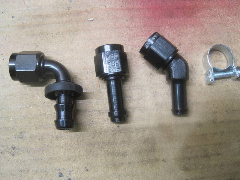

Let me take a slight detour to talk about EFI hose and fittings. For those of you contemplating EFI and going to an in-tank electric fuel pump, the fuel lines have to be upgraded, both in pressure rating and size. Most of our cars are running 5/16" OEM lines; EFI standard is 3/8" or -6 AN. The best approach is replace the OEM hardline with a 3/8" hardline with the correct flaring and use EFI fittings to connect to the rubber hose. I didn't go that route, instead I bought a kit from Tanks Inc. that included the LS-style filter/regulator, 25 ft of EFI hose, and various push lock fittings.
For those of you not familiar with push lock fittings - be warned! They are the biggest bear to seat in the hose. You can watch all the Youtube videos out there showing the different techniques - dip the hose ends in boiling water, heat with a heat gun, coat the inside of the hose and the fitting flares with axle grease, etc. etc. It doesn't matter what technique you use, assembling push lock fittings will ruin your life. It was the singular hardest and most taxing part of converting the fuel delivery system. For context, I'm a 250 lbs weightlifter that can practically hand-torque head bolts to factory spec and I was left curled up in a fetal position in a corner of the garage praying for Sweet Jesus to just take me. I eventually got it done but it scarred me for life.
So I was bound and determined to reuse the existing fuel lines. The only line I had to make was from the fuel filter to the regulator, and I was dreading the moment. But then my neighbor stopped by (same one mentioned earlier) and showed me the fittings FiTech sent him for his install. The company is Aeroflow, based in Australia and unfortunately they don't have a US distributor. It took 10 days for the fittings to arrive - not bad considering. However, I was able to seat the fittings in about 30 seconds. These fittings require an EFI rated hose clamp; the push lock don't require any clamping.
Here's three types of fittings: Left is the push lock (unknown brand), center is Earl's EFI rated and right is the Aeroflow.
Although the Earl's has only one flare, its' still a bear to seat the hose. If you plan on using push lock, consider investing in this tool by Koul:
It's a little pricey at $279 on Summit but it will seat the fitting in a minute. Realistically it will take 20 minutes per fitting to seat a push lock without a tool, times the number of fittings and it becomes an entire afternoon job, assuming your fingers and hands don't give out first.
I ran all SS braided Earls hose rated for EFI....and Earls fittings. The Aeroflow fittings are good also...but I used them them on other projects.

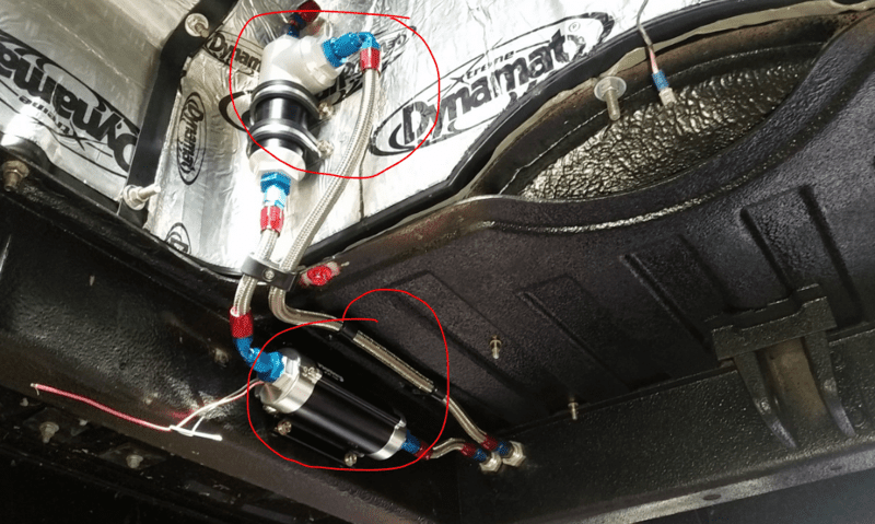

In this picture you can see how we started out - using the Regulator/Return bypass filter - that was replaced after about 5 miles of drive time....a real PITA. You can also see the Holley Billet Pump - another big FAIL - that Holley pump is crap, and so was the next one....so I opted for a German Bosch Pump, and have not had any problems since.
Some pipe closer to the tank. I went for the external pump due to having a truck bed that I thought might come in handy one day... :D

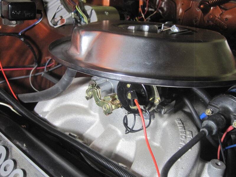

With the fuel delivery system finished at the tank, what remained was reattaching the Lokar linkage and providing juice to the fuel pump and choke.
The electrical was easy. Years ago I replaced the OEM distributor with a Pertronix unit which bypassed the ballast resistor. I just removed the FiTech harness from the ballast circuit and soldered in a connector for the choke and fuel pump.

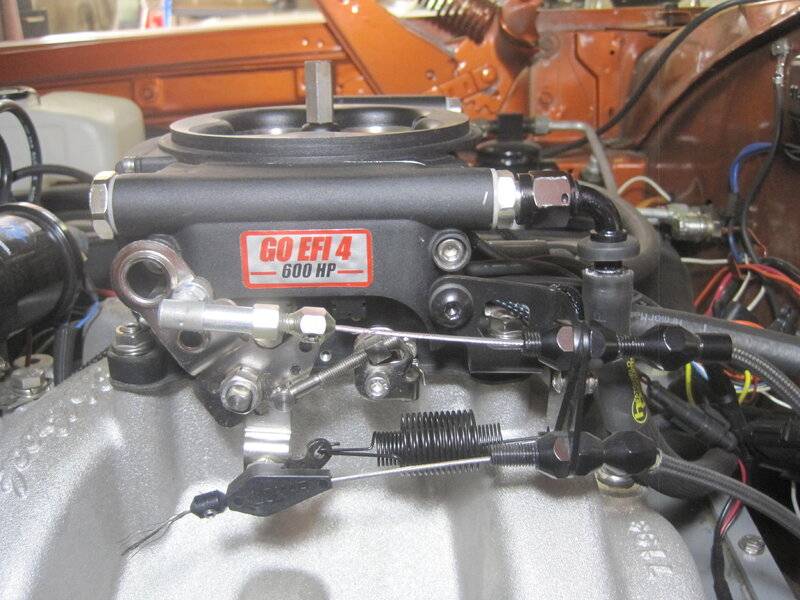

The linkage took a bit longer. Lokar came out with a nice FiTech specific bracket that wasn't compatible with the Edelbrock.
But, taking a page from Greg Kern's best seller "How to Restore Your B Body Mopar on $10 a Day" I scrounged an earlier FiTech bracket that was laying around and it fit on the Edelbrock. Throttle cable and kickdown are in! IMG_5487.JPG

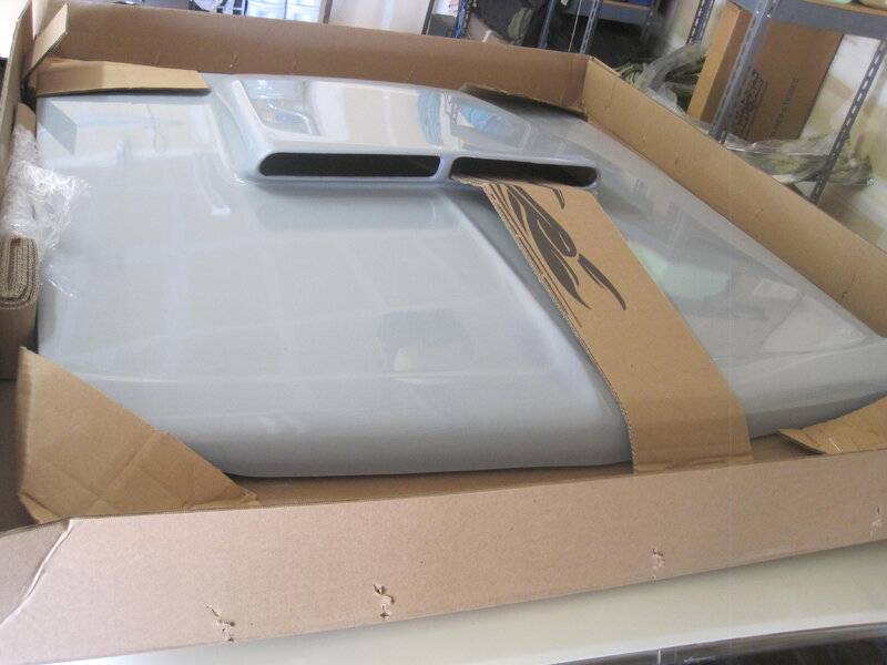

On the back roads out of Lincoln I opened it up and noticed there was still a plateau at WOT. I'm thinking it's the flat hood not allowing enough air. Even though it's an Eddy two plane manifold, it sits higher than the OEM. I had to run a drop base air filter on the FiTech, but it won't fit on the Eddy because of the choke housing.
But there's always a solution:
Fiberglass six pack hood from Stinger/AAR arrived on Thursday. It's the reinforced model with bosses for hinges and the hood latch. The quality of this hood is A1. The top side is smooth as glass, it just needs to be scuffed, primed, and painted. Going with Organisol- replicated matte black.
