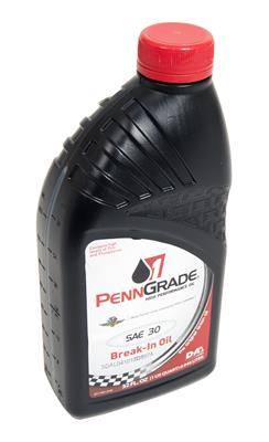

Brad penn here for 30 WT. break in oil and then brad penn multi viscosity from there.
We used to group buy Brad penn at 52 bucks a case or so. When they restructured / sold / added another middle man, the case price jumped 15 bucks or so.

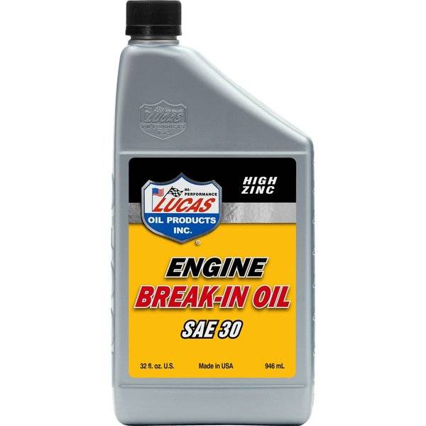

I use Valvoline VR1 racing oil made for no catalytic converter flat tappet cam motors and added a bottle of Lucas Break In oil treatment for breaking in the 16 new hydraulic lifters I got from Comp Cams.
