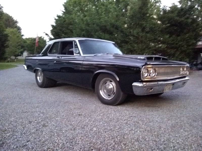

The grille is easy. Cut up a second grille for the headlight filler panels. You will find out that the piece that is used a filler is taller than the part it is replacing. It's necessary to put a little more bend to make the top and bottom line up. The originals are drilled and pop riveted together. None of them fit perfect. Get a scoop and your favorite wheels and have fun. Not every car out there has a restored grille and a Hemi.
