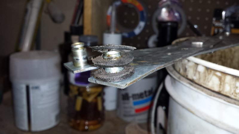

1962 plymouth, where the pins from the regulator go through the bracket attached to the window there is like a oiled up cloth/fiber washer on each side.. somehow i lost 2 of them.. no idea what to even search for. anyone know the proper name of this part?
94 views, kind of surprised no one has ever had to replace these before.... Came to delete the thread but i'm not allowed to :(
These guys?
I'm pretty sure it is felt wool. I made my own washers with a punch.
Yup.. that's them... pissed i lost em.. i have been putting everything in it's own boxes and i still lose stuff :) Yeah.. they didn't feel like leather or cloth, just odd...

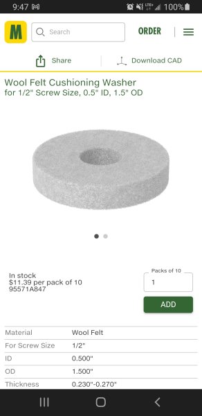

Measure the diameter of the pivot and you can order new ones. These are available from McMaster-Carr but you can find them from a bunch of places.
Fiber washers
