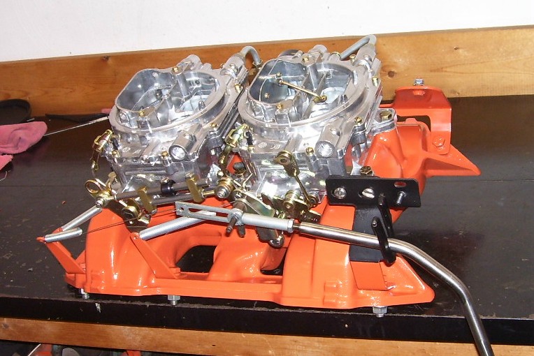

Does that intake flow enough to support those?
i think those intakes, edelbrock ch28, flow about 260-280cfm per port. the real question is; do the cylinder heads flow enough for the manifold. its my understanding that whatever the head flows the manifold needs to flow more and so on with carbs to prevent any restrictions. not a straight forward answer but probably close to the correct one. those are 600 edelbrocks and i believe the manifold will flow more air than the carbs.
Ah I thought they were bigger...LOL
Yeah heads are my next decision for the 440.... thinking about some Edelbrocks for the cost of them, the car is not a racer but I do want to have more get up and go..
Ebrock makes it easy to use thier system/stuff and mopar engine stuff is not my strong suite

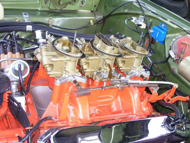

Boy--them Holley 2-bbl's sure look nice..BUT, you really need the gears,heads & exhaust to make them work..
actually that set up ran better with a 3.23 rear vs a 3.55 or 3.91. they don't "need" a bunch of stuff to work; just a good tune. but, extras are iceing on the cake.
