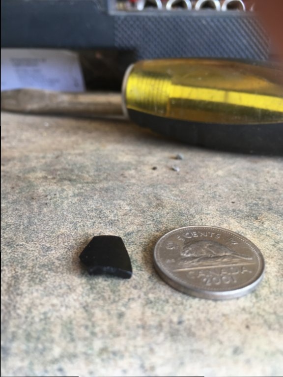

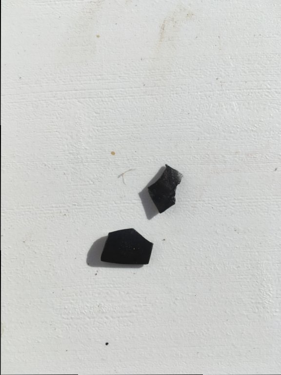

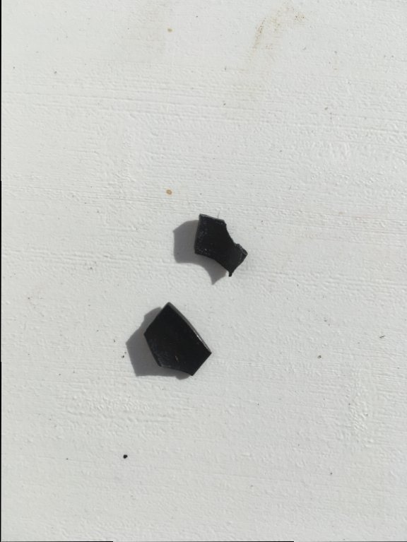

I was changing the valve cover gaskets and found these laying in the corner of the head on the passenger side. They are made from some kind of plastic it seems. Can anyone tell me what these pieces are from?

Hard to tell how big, or small, they are with nothing to reference them to in the photo.

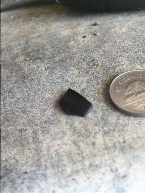

The pieces are about 1/3 the size of a nickel.
They were in the rear corner, aftermarket fugly chrome covers and the PVC is on that side but at the front of the cover.

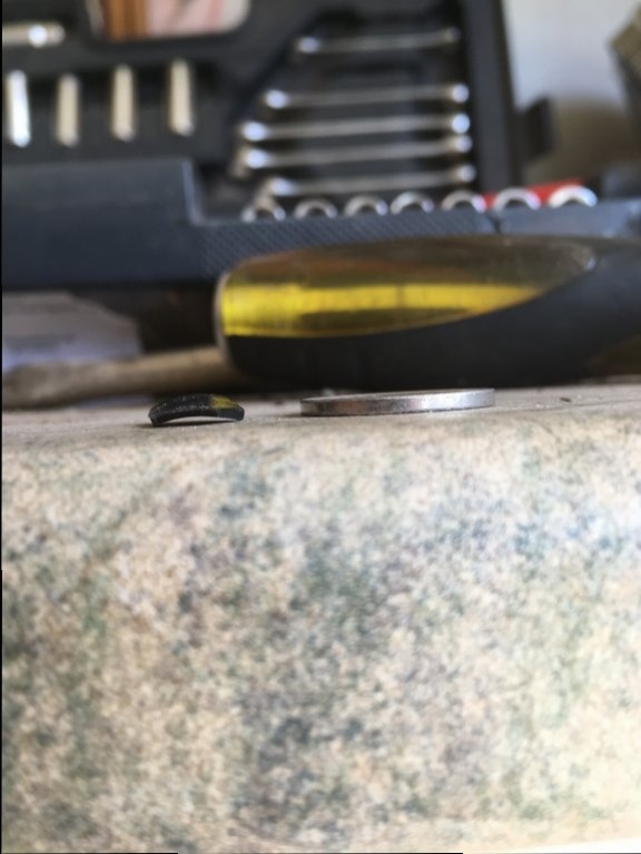

They are hard as a rock and quite brittle. I thought they were metal at first but after closer inspection they are some type of plastic.
I dont think it was the valve gaskets, its very smooth and sort of rounded or U shaped. I thought is was a valve guide at first. I will get a better picture.
Dollar says it's the valve seals. If they are falling apart, I would be surprised if it doesn't smoke all the time. Shut her down until you get it resolved or you might end up with a LOT of other problems as well. You can change seals without taking the heads off but I would pull the heads and maybe the oil pan to see what you are looking at and get everything cleaned up.
after looking closer and seeing the rounded shape, I agree on valve seals, not gasket
Just part of the game, olddog67. Those type seals don't last forever, then they start breaking up.
