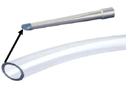

Here's an easy test to try before having to remove the oil pan to look for additional debris. Drain your oil pan. Take some small diameter clear hose and run it into the small bladed attachment of a shop vac. Seal the attachment end with gray tape. Now you have the flexibility to work the bottom of the pan through the drain hole. If a piece is to big for the hose it will still stick to the end of the hose. What you pick up will give you some idea as to whether you need to drop the pan and do a thorough cleaning.

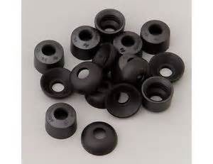

Here's a pic of the stock umbrella seals, so you know what your looking at...
