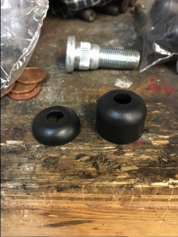

The engine shop called me and he can't get the seals he recommends I use. Great...
He did say something that jogged my memory, I have an old Mccord gasket kit for a 440 and there are seals in it.
Would these work on my 383?
**after having a second look I actually have 16 of the tall seals and 8 of the small seals.

I did end up installing the ones I had. Went pretty good. It took me and my father in law almost 6 hours. I used the spring compressor and did have to hit it to loosen the keepers up.
