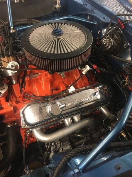

Been driving the wheels off my belvedere. Waited a long time for the 451 and she screams.

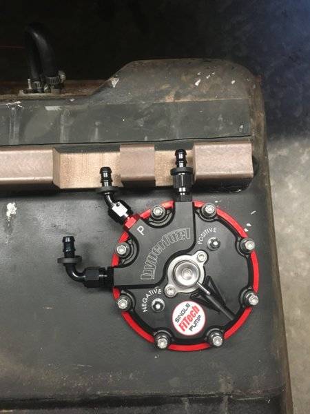

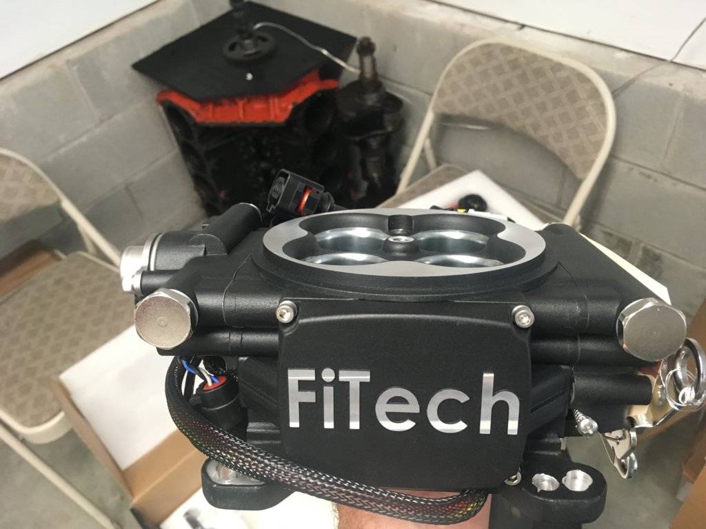

Oh, and just picked up this little number... going in in a couple weeks...

That looks really nice, please post when you have it installed and let us know how well it works and what you think. I want to do EFI at some point.

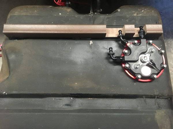

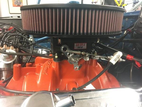

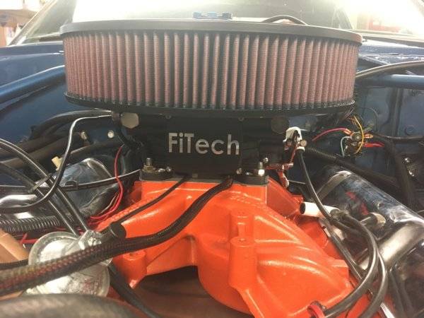

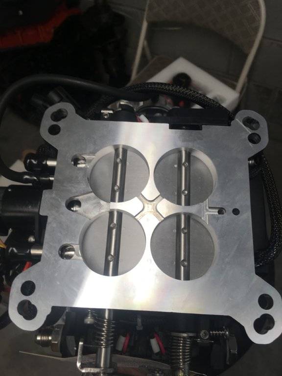

Just about done with the install. In-tank pump is in, tank reinstalled and throttle body is in place. After going 10 rounds with the driver side header, im packing it in for the night.
Had to space the tank down a bit. Found a composite deck spindle to be the perfect size...
Almost a shame to hide it.
Tomorrow's forecast: wiring with a chance of plumbing.

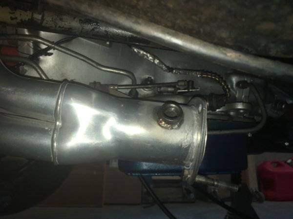

Decided to put the sensor in the collector, FITECH says it'll work fine... we shall see. Had the welding students at school put the bung on. Went a little wild with the wire brush but all in all a fine job.

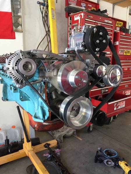

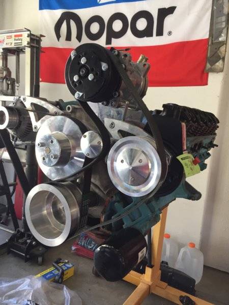

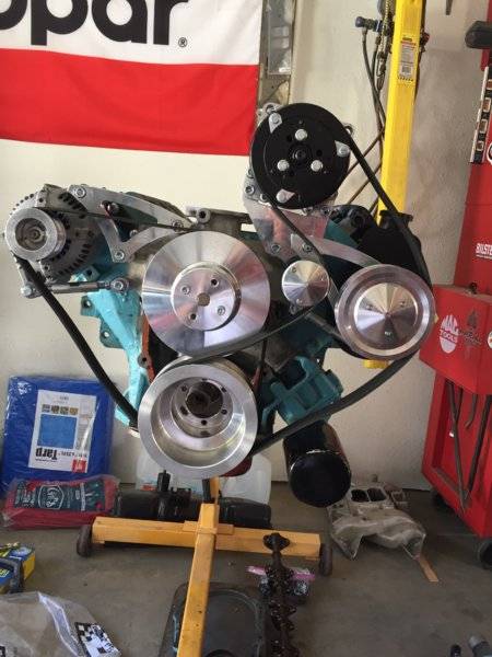

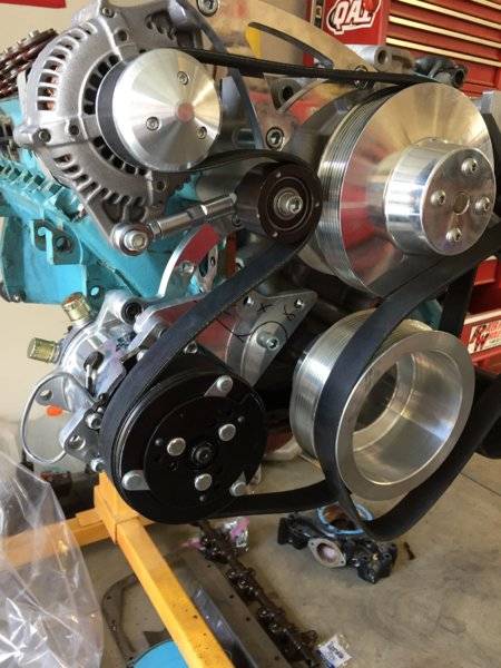

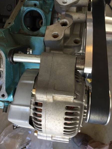

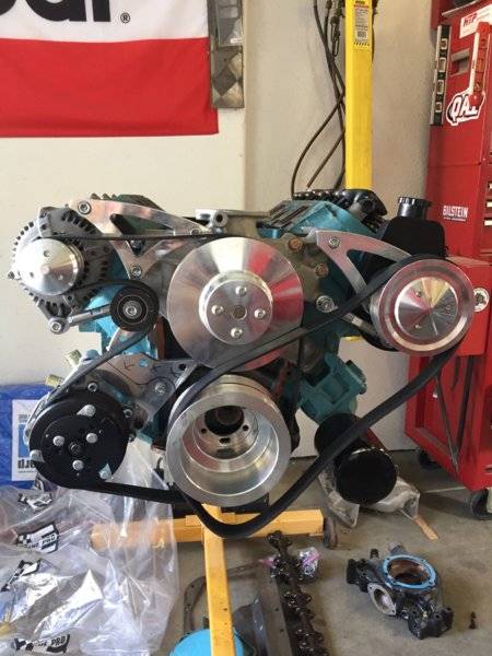

I bought the CVF Beast serpentine set up from Derwud and got a chance to mock it up on my 383 that spun 2 rod bearings. Anyway, the alternator is a 1 wire, 100amp but I don’t like it. So I took the pulley off and made a bushing to fit my Denso 120amp. It worked out perfectly along with making a different length spacer for the top alternator bolt.

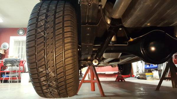

I am soooo slow-- I t took all afternoon to check over everything, clean stuff, install gaskets and axles, gear oil and additive, brake drums , and wheels-tires
Brutus is ready for a test run . Finished everything right before supper time. Rained off and on all afternoon and this evening --2 1/2 " and still raining. I sure hope tomorrow is better--I am anxious to try this gear ratio out......................................MO
Finally stopped raining , after nearly 6" total. Sun came out , and so did Brutus. I am really pleased with the 3:23 ratio and 28" tall tires. It will be much better with the amount of highway miles we drive. The difference in acceleration is not all that much. And the noise I have had at about 2000 rpm 4th gear, is gone. I think maybe I will replace the 275 / 60R / 15 Nitto DOT Drag Radials with same size Cooper Cobra's..............................MO

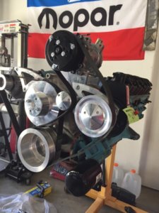

As some of you know, I bought the CVF Beast serpentine set up from Derwud. Well after taking a long hard look being mocked up the way CVF has it, I didn’t like it. So I set out to drop the ac compressor down low on the passenger side. It’s almost done, just a few cuts and it’ll be ready.

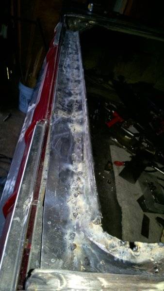

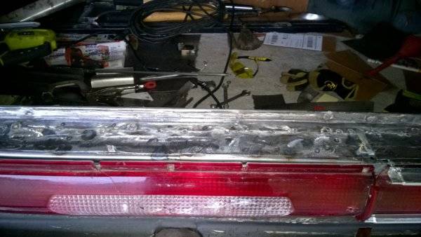

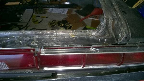

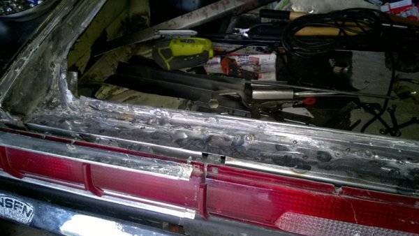

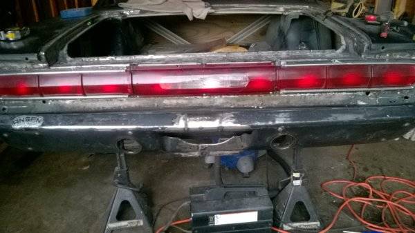

Sewed up the trunk seal rail behind the tail lights, I spot/plug welded everything from the bottom where it wont be seen. Next is a nice strip of 18 gauge to close out the surface above the tail lights. Need to do some more clean up of welds and make some tweaks but it is coming together the way I planned it to.
WP_20171008_18_32_35_Pro.jpg WP_20171009_16_45_27_Pro.jpg WP_20171009_16_45_30_Pro.jpg WP_20171009_16_45_33_Pro.jpg WP_20171009_17_22_18_Pro.jpg WP_20171009_17_22_41_Pro.jpg WP_20171009_17_22_51_Pro.jpg

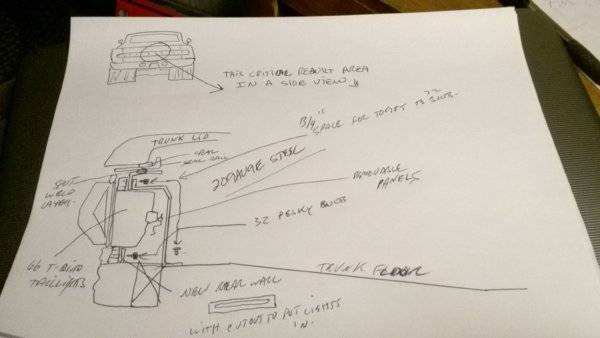

I hope your putting the tires on it you show in your sketch!
