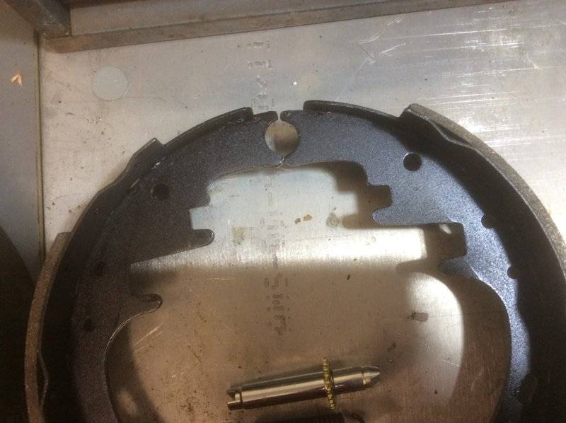

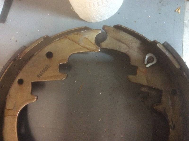

Put drums and tires/wheels on adjusted brakes. Fixed don't think so, didn't find anything to say fixed. Lead shoes have a little less material on top. If I still have a swish, swish, swish I'm going to put some miles on before any look see. Painted the backing plates where scrapped up while installing rear. Gold old shoes black new note more material lead gold shoe.

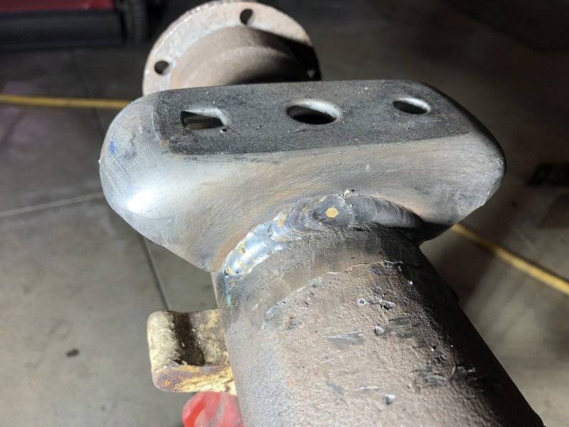

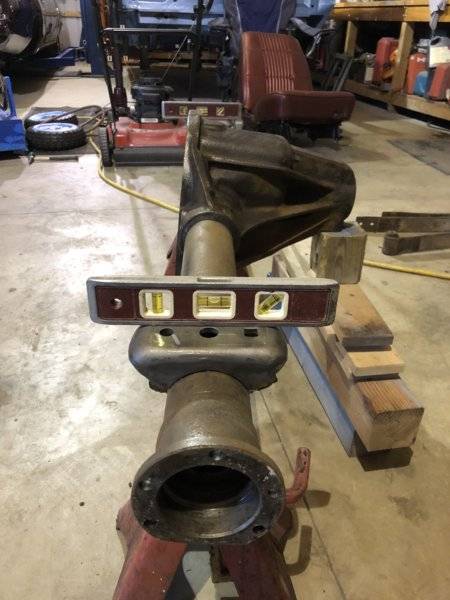

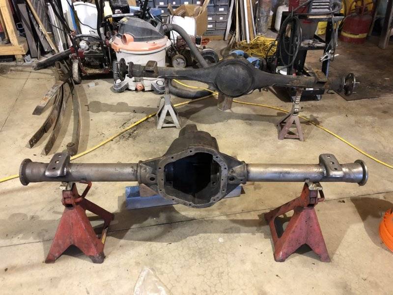

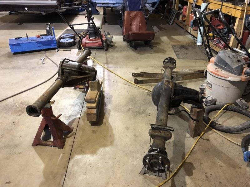

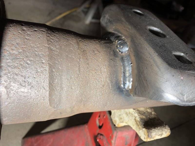

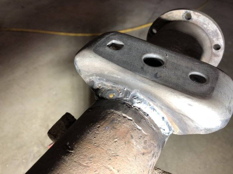

Welded the new spring perches on the Dana. Somewhere along the lifetime of this one (like many others) someone moved the perches inward. I ground them off and returned them to the factory location. I used the 8.75 the came out of the car to index the perches for proper pinion angle.

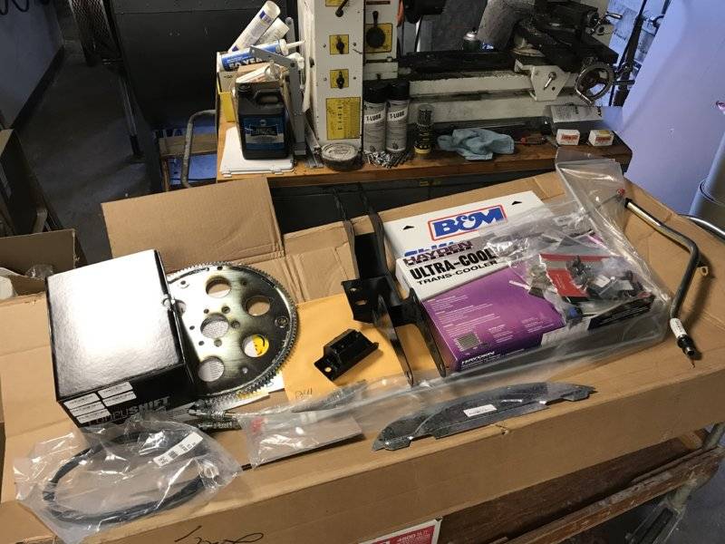

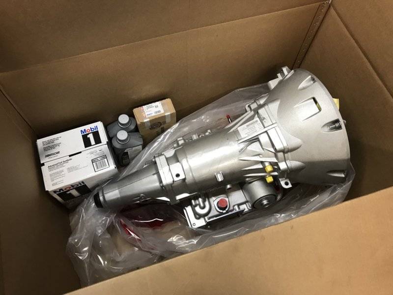

Spent about $1200 at A&A Transmission
Torque converter
Valve body
Flex plate
Misc....

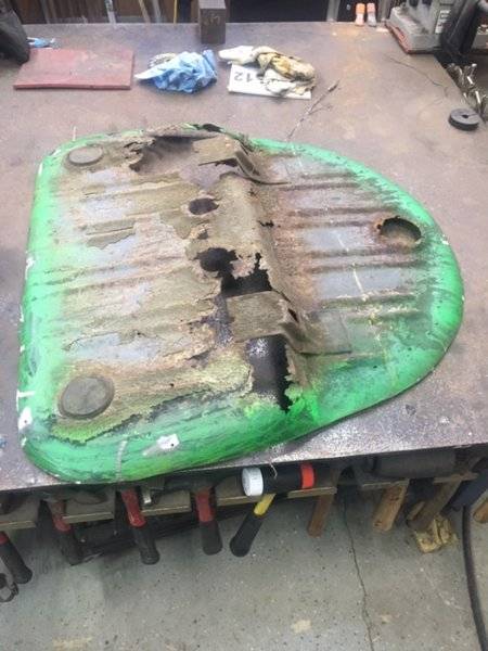

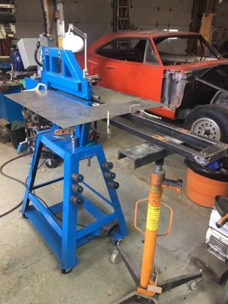

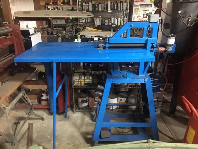

Started building a table for my bead roller so that I could build a replacement panel for the 69 Plymouth wagon I am working on.
Nice work, very clean.
I finished my bead roller table and then discovered that my lathe has issues so now I have that tore apart...
