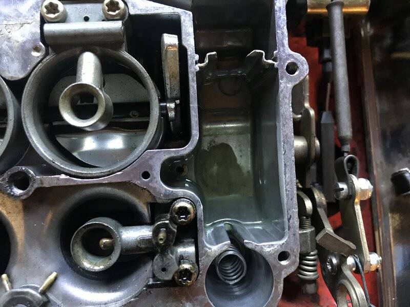

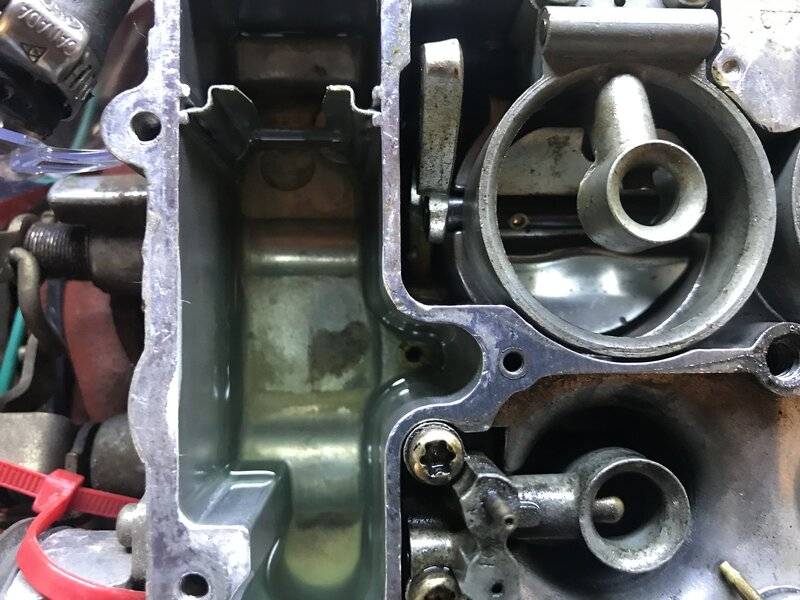

If your fuel filter is really up to doing its job, the carb should still be getting clean gas.
Supposed to be a good filter. Lost of small crap in the bowls. Can I use brake cleaner to clean the carb? Nevermind, I found some old carb cleaner. May have to also use a little brake cleaner. First time taking a carb apart. Wish me luck.

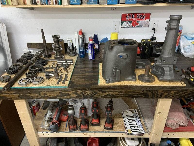

Went for a drive in the Power Wagon Then cleaned and readied all parts to assemble my 4-speed tomorrow.
View attachment 954757 View attachment 954758
When I first got my Road Runner running after it sitting for 17 years, I put TWO filters on it, one before the fuel pump and one after. I STILL got a very fine beige silt in my carb. After needing to get towed back once from it, I had enough, I replaced my fuel tank and had no more issues.
I would think you at least need a very good clean out of your tank, or maybe replace it.

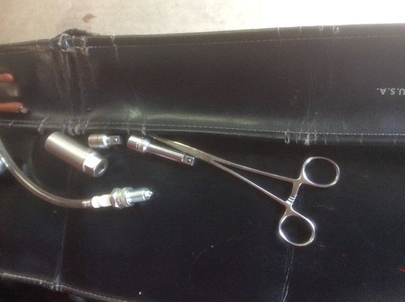

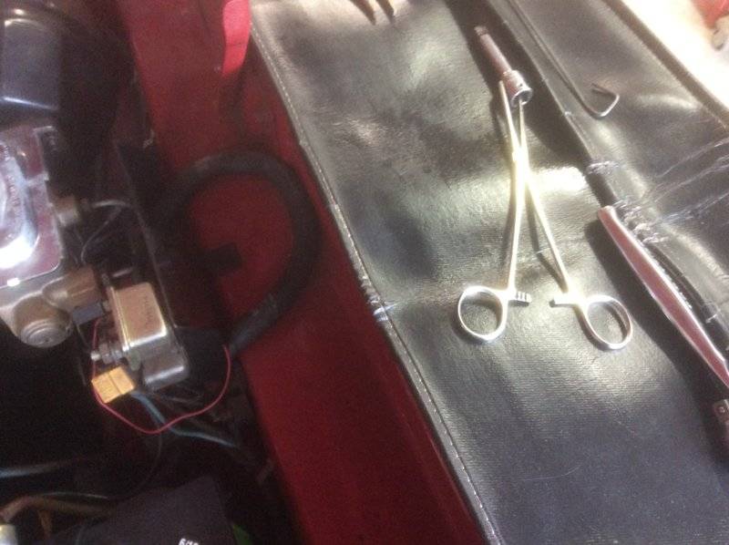

Changed #7 spark plug, that PB booster makes it a pain. 1 Remove air cleaner assembly. Drop spark plug socket (regular socket won't fit) down tube, 3" extension on 1" extension ratchet wrench. Unscrew plug, remove ratchet ( fun time)remove 3" extension without dropping 1" in the hole. Remove 1" and hold spk plug socket and remove that with sp plug. New sp plug put 1/4" hose on tip put it in tube carefully start threading. Once started remove hose and put plug socket in hole without foam insert, if it stays on plug you'll know why. Now put 1" extension on 3" extension so that 1" extension goes in the tube first. Tighten plug, remove ratchet, now the fun pull 3" extension and grab 1" extension remove 3" extension while holding 1"extension. Pull 1" extension so you can hold sp plug socket. Remove 1" extension and then remove sp plug socket. After all that crap thought maybe a fine cable or fishing line through socket drive and up the outside to make it easier to remove everything, next time. View attachment 941362 View attachment 941363 View attachment 941364
Snap on makes a 5/8' Spark Plug socket ( do not know about 3/4 , 13/16, or 14mm) that has a magnet inside in stead of the rubber. Be careful though so many bought it and broke the magnet , that they do not warranty the magnet. So I crack the plug loose with any socket, the use same extension set up and the snap on to get it out and put it in. Part no. S9706KMAG You can also get extensions that have a square "ball" instead of the round style on the end of the extension. but to get the socket ( or what ever ) off the extension you have to manually push in the square edged "ball" with a pocket screw driver. BUT IT CAN NOT FALL OFF.

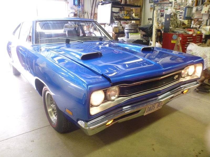

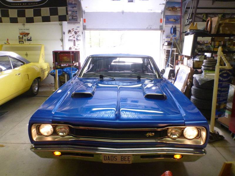

Well the laneway has dried out earlier than usual, the gravel road is dry and the town has had the DogF crew out for weeks sweeping the streets of sand, so only one thing to do. It's time for some "essential travel"! Hasn't run since the night of our Daughters wedding on Sept 21st, 7+ months ago. Two taps of the gas and a quick crank and nothing but music!
View attachment 942309 View attachment 942311
I CAN"T hear it!
Hawk
Thanks Hawk.
Basically the same issue. After cleaning the fuel filter and carb out yesterday, I took it for a short ride. (dumb move). It was good until I was a few blocks from home and it started bogging down again. I stopped at my neighbors (chevy guy) to see what he thought and it died. I noticed the fuel filter was almost empty but after a bit it filled back up. Couldn't get it to fire up again. grabbed some starting fluid and it started and died. I'm hoping just the fuel line is clogged but I'll probably take off the fuel fuel pump and clean it out too. Getting a new tank, sending unit and some fuel line ordered. Probably gonna put in 1/2 inch. oh well, another day more money spend on the hobby.

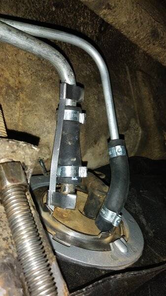

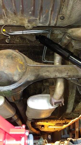

Finally able to replace the original tank and lines. Went from 5/16 to 3/8. Still not sure why the smaller line was used when the sender was 3/8. Reused the original sender and still works perfectly. That undercoating they used back then is a bit crunchy when it gets in your mouth. Took it out for a good cruise. No runs, drips, or errors.

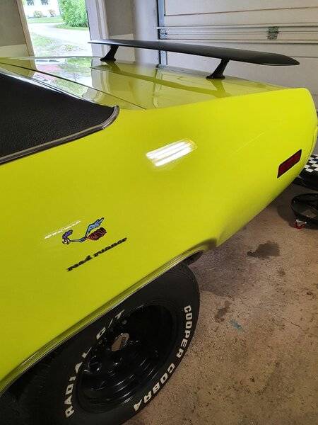

Satellite is back from the paint shop after only 2 months (might be a record).
Putting interior back in and exterior trim back on.
It has to go back for some touch up work and a couple runs but I have to go buy more paint and I'd like to get it color matched.
That means I get to drive it there.

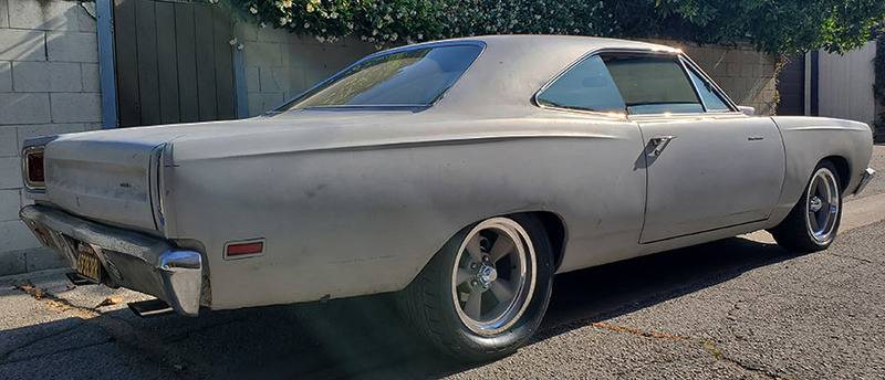

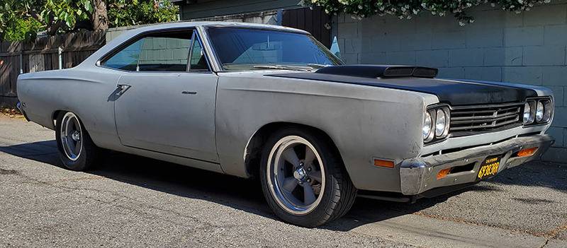

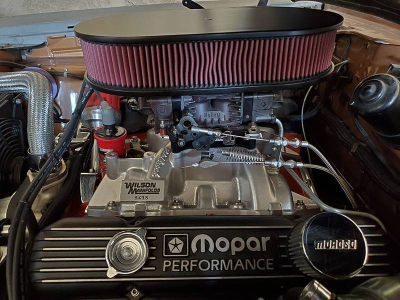

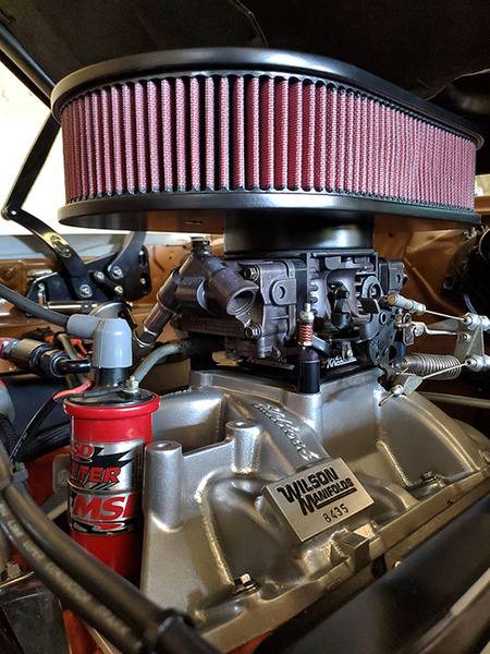

Finally got the Wilson ported intake on with the 1" tapered spacer.
Definite improvement, with the EMS AC there's about 1" (or less) of space under the hood scoop so it all worked out.

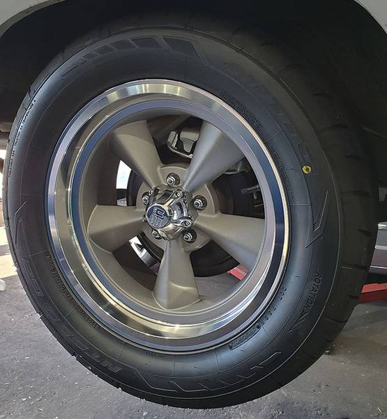

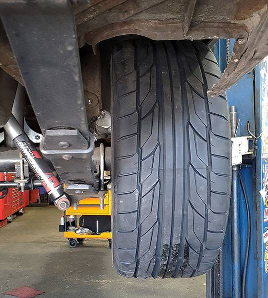

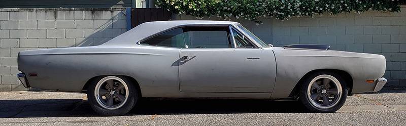

Got the new wheels and tires mounted with an alignment, with new 2" drop spindles.
I'll try another early morning canyon run this weekend to see how it all works out, hopefully I don't mess up the RR or kill myself.
