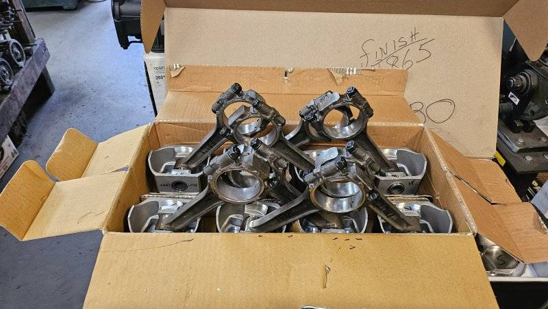

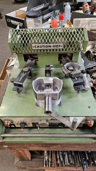

Assembled the pins on a set of forged 440 slugs.
For those not familiar: The machine below heats up the small end of the rods so the pins can slide in (when at the same temp there is a .001" - .002" press fit). The part that holds the piston allows for an adjustment so that when you press the pin in the rod is exactly centered. It works well but you have to be fast and perfectly aligned or they get stuck!
All done! Now to file fit and install rings.

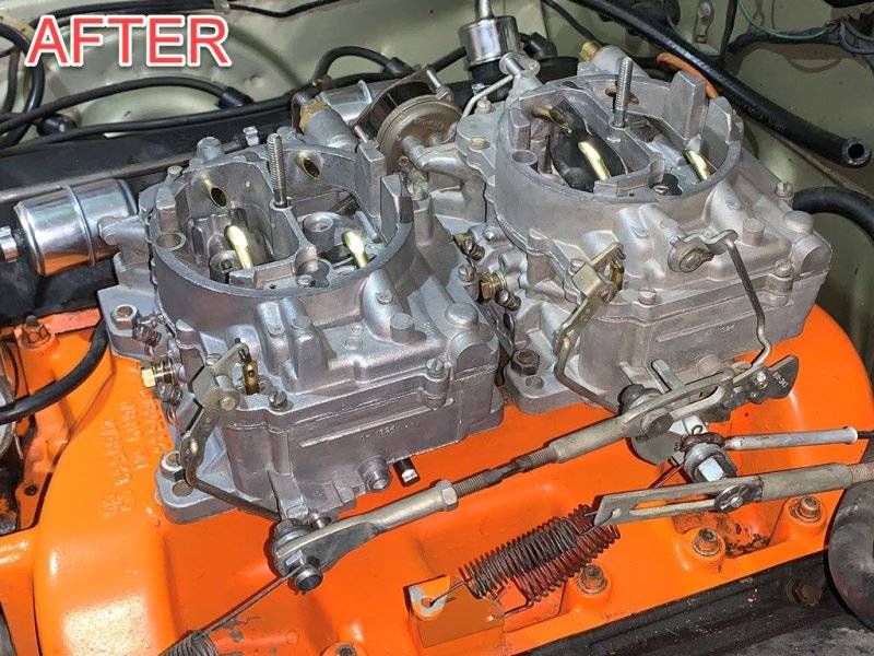

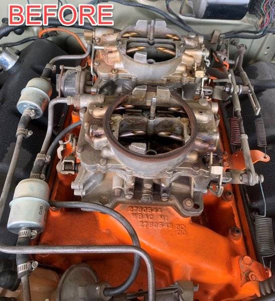

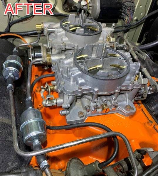

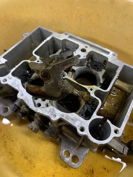

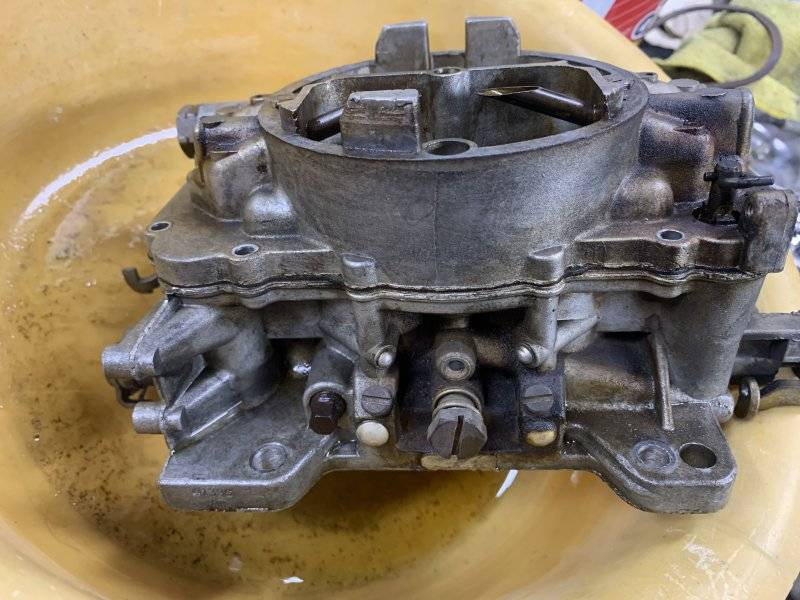

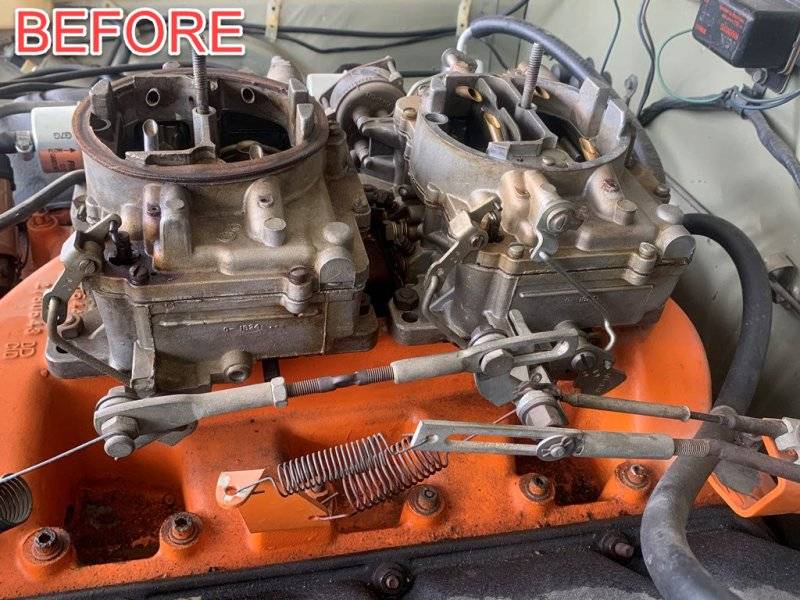

Working on cleaning and rebuilding the front carb
Musta been a mouse :eek:

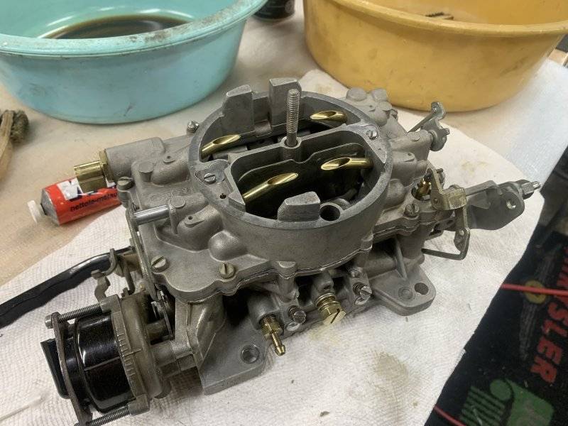

Finished rear carb
Fired it up, backed it out and went for a cruise to fill up the tank from a half tank $24.00.

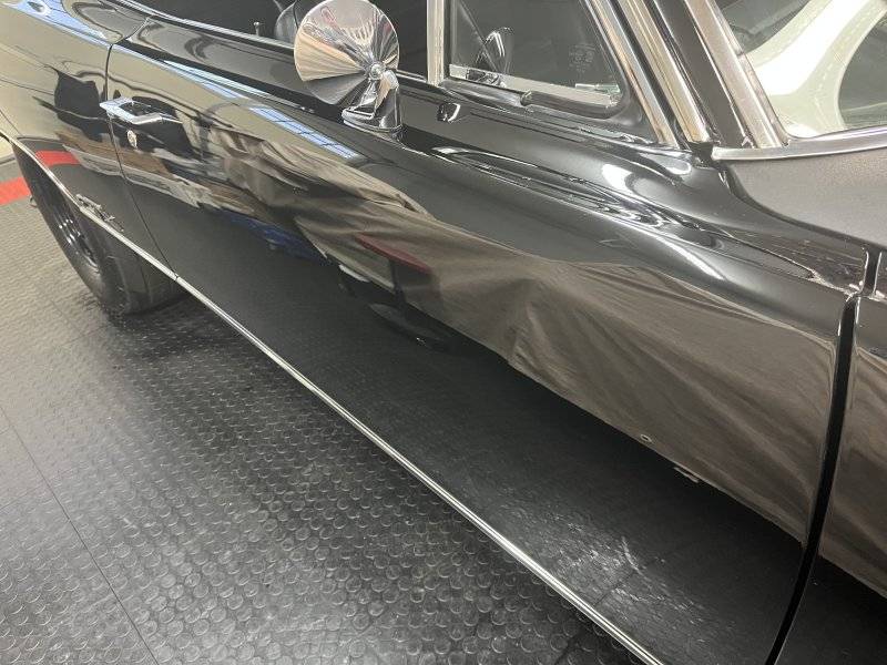

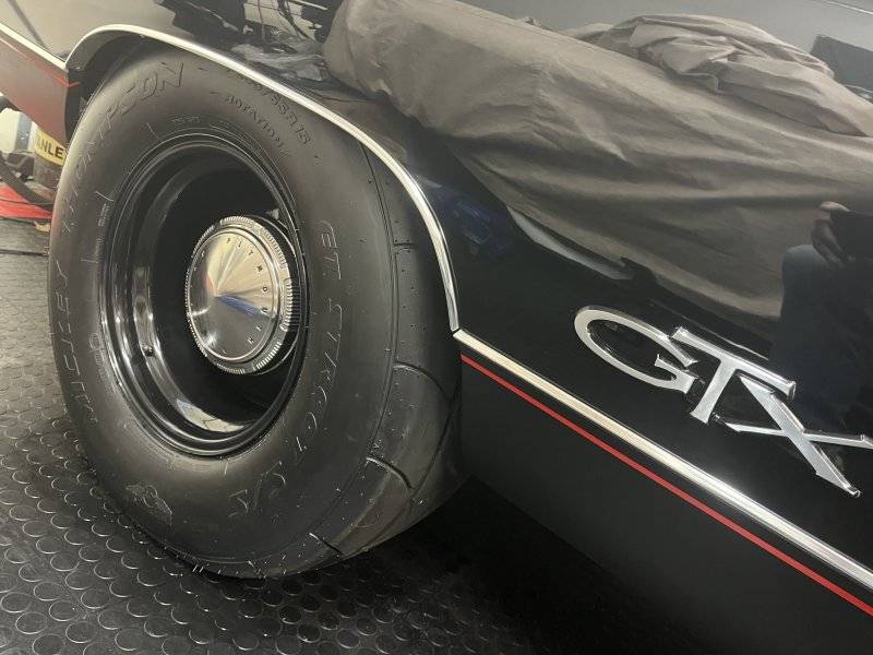

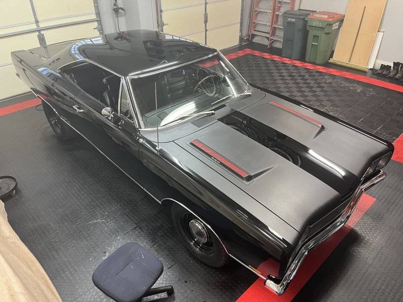

The GTX has been uncovered most of the winter while I replaced the exhaust system and did a handful of other small projects. It was pretty dusty and full of hand prints so I spent part of the day cleaning up the exterior. If it’s nice tomorrow I may pull the GTX outside to clean up the garage floor and move the truck to the middle bay so I can do some work on it.
Cruising is still about a month away but the GTX is ready to go…
How do I know that I am not worthy with my measly Road Runner and garage?
When a guy has a beautiful GTX with a garage floor that matches their car!

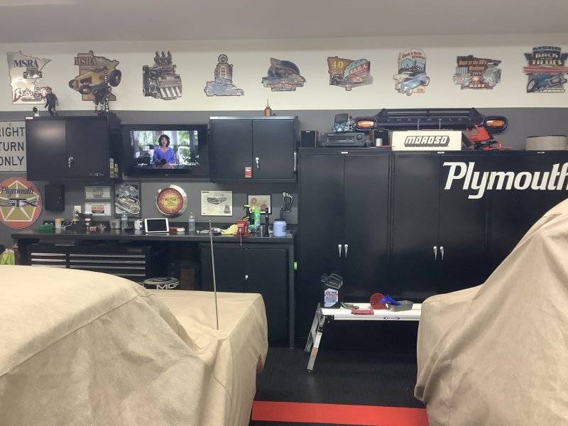

When I finished building my ‘58 Apache my wife suggested giving the garage a makeover because it was looking pretty rough. I finished the drywall and painted, got some decent storage cabinets and put down the Raceddeck flooring.
Pardon the mess, today is clean up day…

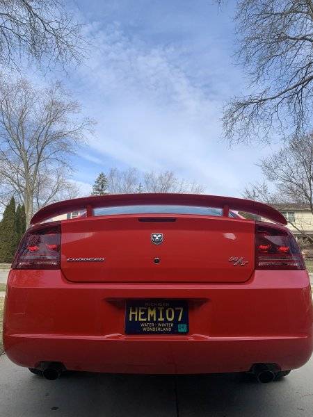

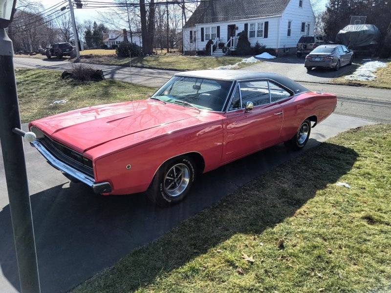

Easy job, plate came in for the wife’s car, changed oil and then took cover off
and went for a nice drive, sunny and 48 today

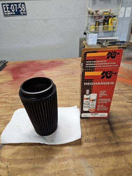

Cleaned and oiled the air filter on Cora.

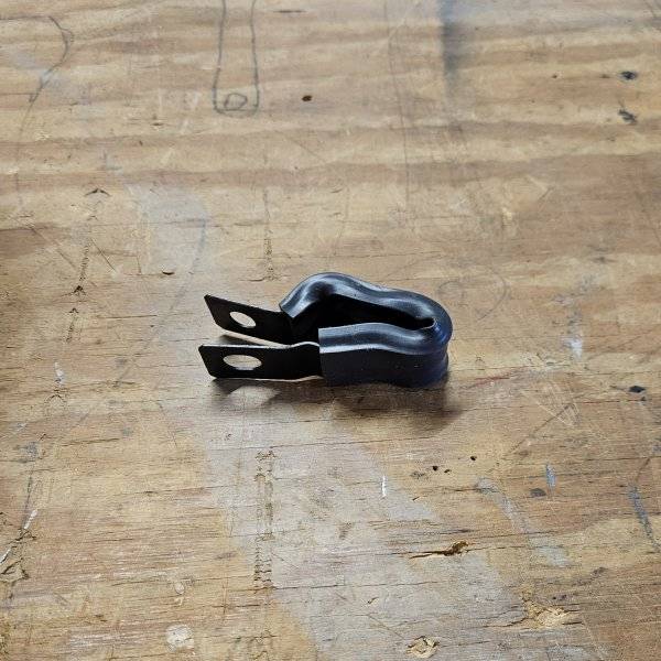

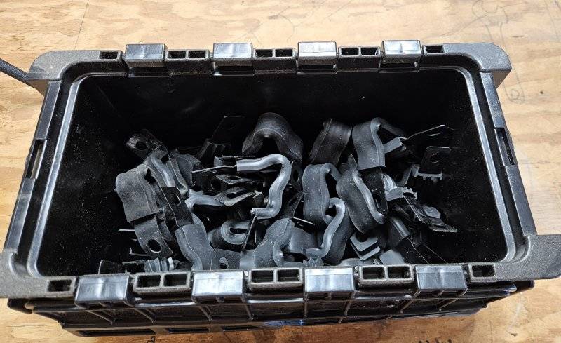

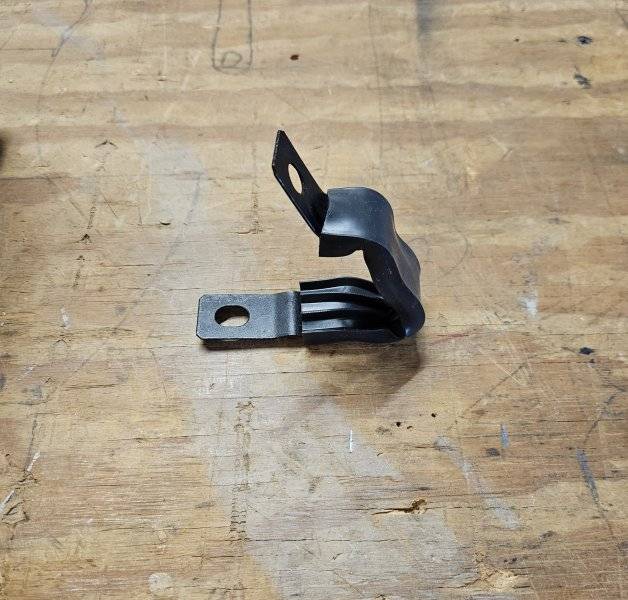

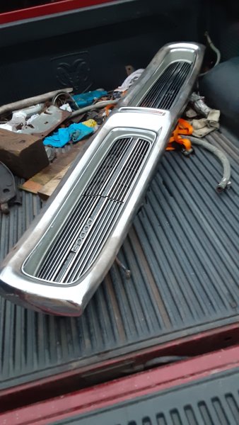

I used these on all my cars when I was building them. They came in very handy and looked straight and clean. I don't need all of them, if you do, ask. I don't sell, I give.
