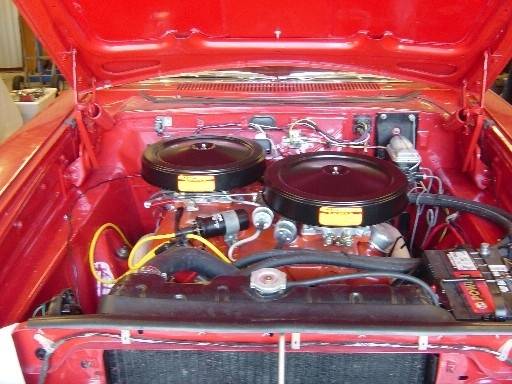

Put caps on, the other day. Cleaners from CrossramConnection. Slipped right on, with no problem, on the Eddys. Nother one bites the dust.
