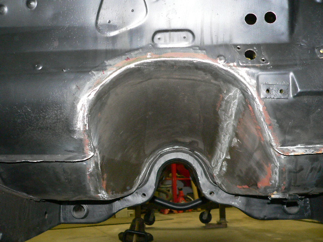

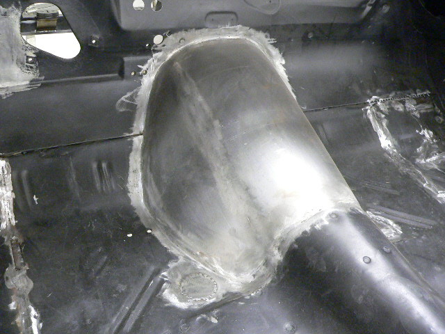

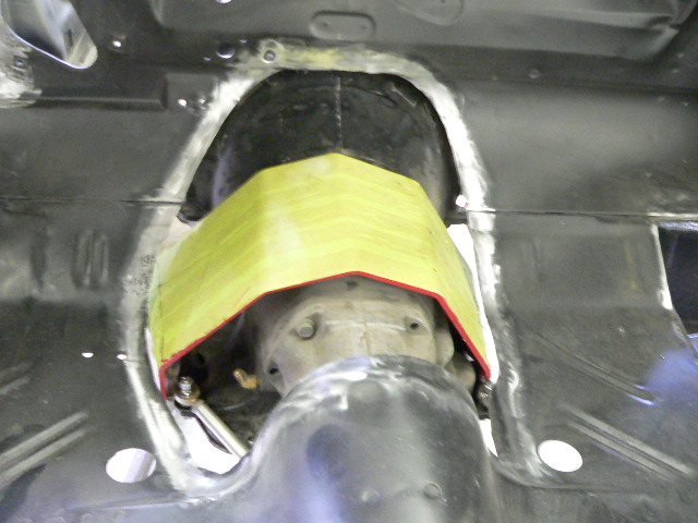

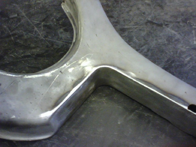

Late model (66-70) K-frame will slide the motor back. This is good because the fan to radiator clearance is tight. These cars came from the factory with a 413 option so BB fit easily. Trans tunnels are tight I cut them open and make the tunnel 2" higher 4" wider. All suspension is the same except the idler arm matches the year K-frame being used. Just like any other B-Body trimming the K-frame is good for pan clearance and removes weight. These pics are from a 64 but will give you an idea.
Doug
