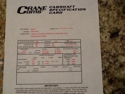

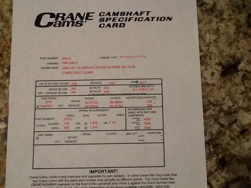

So, I have multiple cams. One is a Racer Brown STX-22. It seems they still sell that one and I know it's quite legendary.
This is the one I have in question;
I was able to get the cam card from Crane still. They did not offer up much other info.
Has anybody run this cam? My goal with this engine is to actually use all period correct parts and build an engine just like how people used to do them back in the day. I even want it to sound like it...noisy pistons, clacking cam, Pete Jackson gear drive, etc. a real street warrior per-say. I have standard and 1.6 intake rockers.

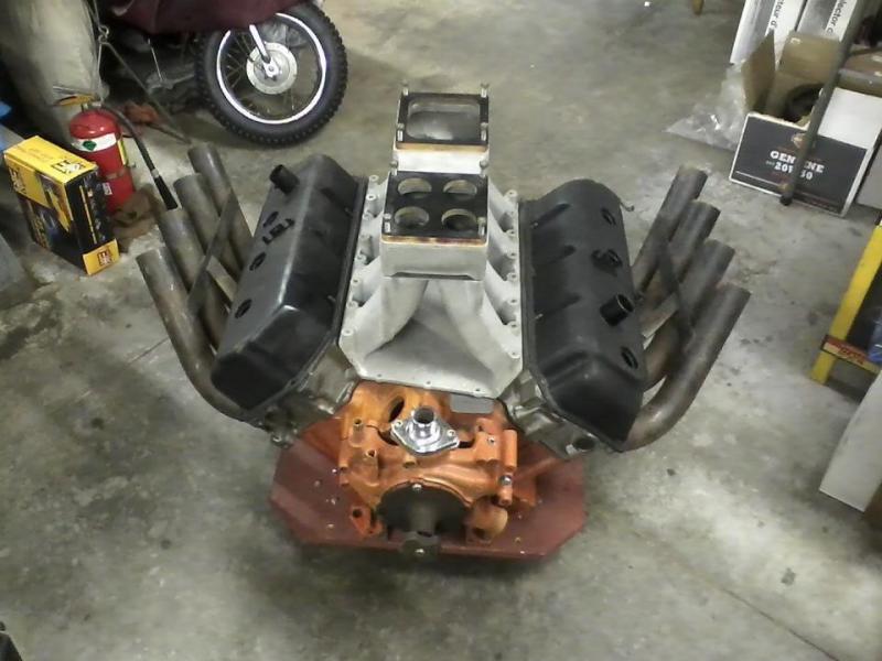

I plan on using a Edelbrock STR-11 Tunnel ram with dual 1050 dominators, or possibly a Vanke modified dual quad and a pair of 650 AFBs. It depends on what I put it in.
Here is the beast sitting in mock up.

All I can add here is based on info I have read, you might consider not using the 1.6 rockers. I like the build theme! Now if you can only find something to build into a gasser.
Yeah, I get that. It may delay closing to the point where cylinder pressure is affected. Honestly, I have a rebuilt set of OE ratio rockers and the geometry is better with them anyway.

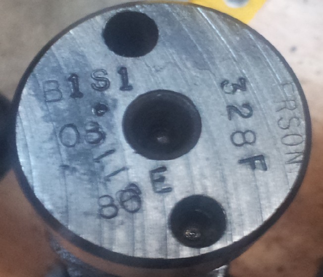

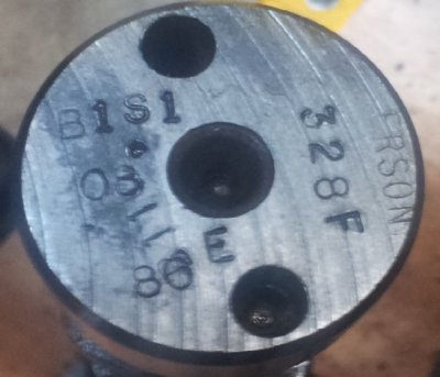

Does anyone have application info on this Erson Hemi cam?
