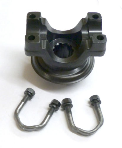

With my Viper T56 installed it's time to look into the driveshaft, the Viper slip yoke is already pretty massive but I'm looking to add some insurance on the other end. What do you think of this one, it's forged steel, takes a 1350 universal and I would think the U bolts would be a better setup? Oh yeah, I'm running an 8 3/4" rear.
It is only as strong as Pinion and Housing is fair on 8 3/4. A Dana 60 would greatly improve reliability.
I'm sure it would but I'm going to abuse this 8 3/4" for now, if I break it which I don't think I will then I'll be looking to upgrade it as well. I'm running nothing but street tires so I'll lite them up before I hurt something (I hope).
8 3/4 will handle just about anything you put to it, when you start putting massive horsepower and slicks at the drag strip then you might need to thin about upgrades and if i was i wouldnt be using a standard dana 60, i would get a custom strange S60 or something like that
747 i have the same yoke as that pic on my 8 3/4 nice piece strong as anything,
Good to know, there's one on Ebay for $80.00 (free shipping) right now that I may just snag up.
Looks just like the one on my 8-3/4 with an Eaton TrueTrac
Go for it Devin! You need it!
Make sure you get the correct number of splines for your pinion.
Already checked it (10 splines). Thanks
