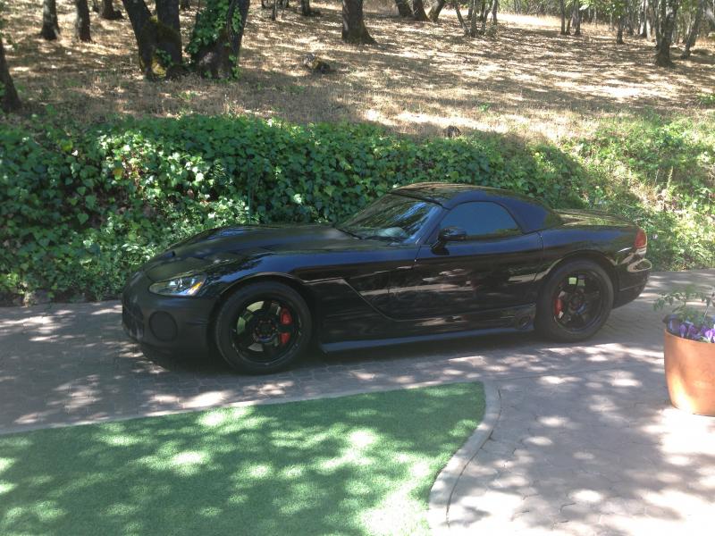

I have a 04 Dodge Viper 550 HP motor with the Tremec 6 speed. (still have it) 2013-07-07 08.51.35.jpg2012-07-28 11.01.47.jpg I run a 3.55 dana. I had a 2.73 and the stock 3.07 also. the 2.73 was a terror but called for 5th gear near the end of the 1/4 mile. The 3.07 was just to difficult to manage in any kind of traffic. The 3.55 was the best overall performing going thru the trap at 125 mph 11.55 at the top of 4th.
