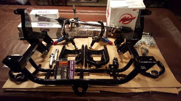

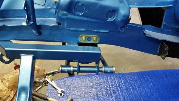

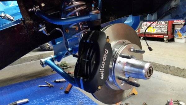

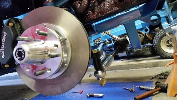

Tubular K Frame & Tubular upper & lower control arms & coil overs here so I can run my 10 quart flat bottom oil pan. No more torsion bars either.

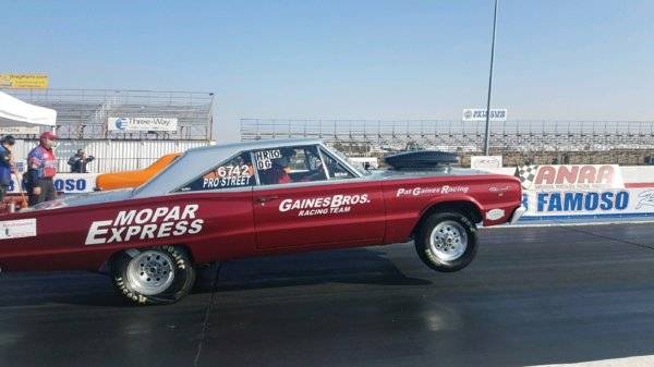

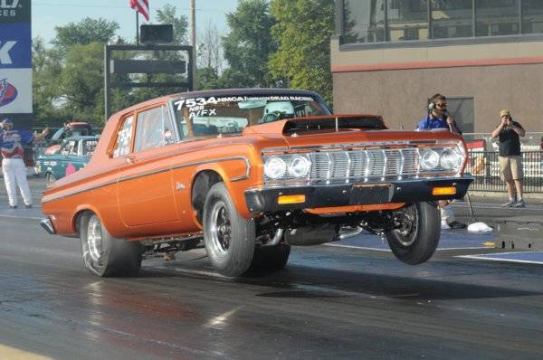

Stock stuff here except for tie rods. Save the money for good shocks. You'll be way happier. Been 1.240 60ft on the stock front stuff. Car runs 145+
Doug
I run stock front suspension, torsion bars and all.
I have Calvert 90/10 front shocks.
CalTrac wants 5" of free travel on the front end with their complete setup in the Rear (Mono Leafs, Bars and CalTrac 9 way Adj RR shocks)
so I unscrewed the torsion bars and let the front end "sag"
When I put a floor jack under the K-Member and start jacking the car up, my front fender comes up a full 5" before the front tire lifts off the ground...walla...5" of free travel.
IT WORKS for me. Off the transbrake at 4000rpm the car pulls the front wheels about 15" up for about 20 feet out...cant complain about traction.

The Cuda I'm installing a Gerst set up. Its not just for header clearance. Dont have to run the center link thru the pan, more adjustment, lighter weight and yes even more clearance for the headers. Those $800 headers run real tight on the starter and trans. Melted more than one trans blanket and burnt up a starter or two over the years.

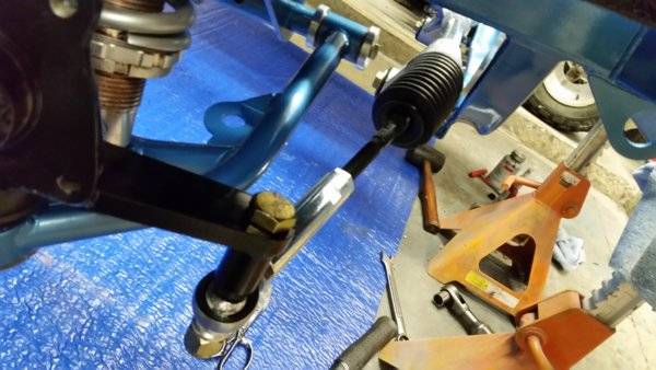

What tie rods you running
I run the Speedway adapters with heim joints on the outers, stock inners. The sleeve is a hybrid I fabbed. Stock inner welded to the speedway outer that was cut in half. This allowed the outer tie rod height to be adjusted for zero toe change thru the travel. To be honest is was pretty decent to start with.

Qa1 UCAs, LCAs, Qa1 double adj shocks and strut rods. I'm going to go ahead and order their K frame as well. May go ahead and upgrade the torsion bars while I'm down there.

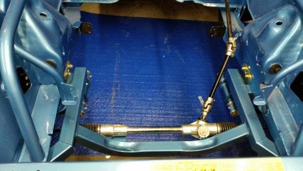

Cutting up the stock K-frame isn't a big deal. You can get them Pretty light. The stock upper arms are light as well. As far as strut rods. You cut the ends off and throw them in the lathe. Then weld the OE ends to Moly tubing. While you're at it make the steering shaft from .750"x .090" tube as well.
Doug
Doug
Wow thats a clean k member dont look like its weakened it at all
