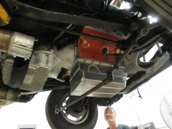

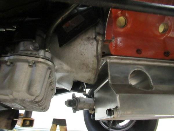

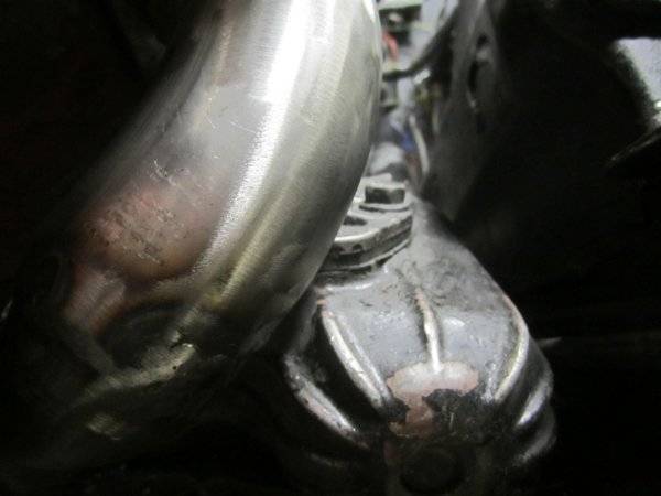

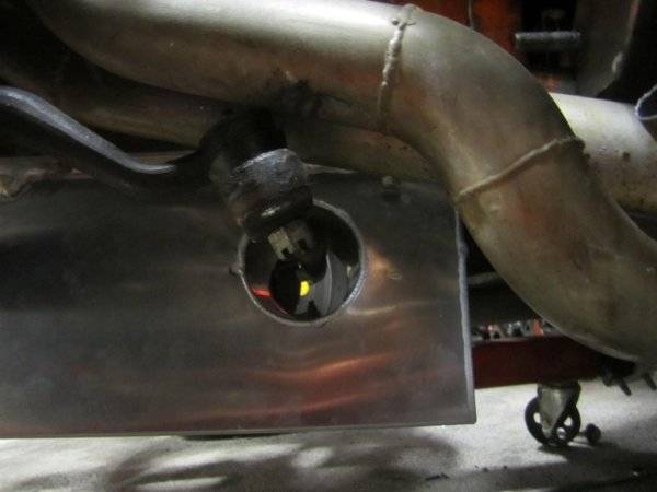

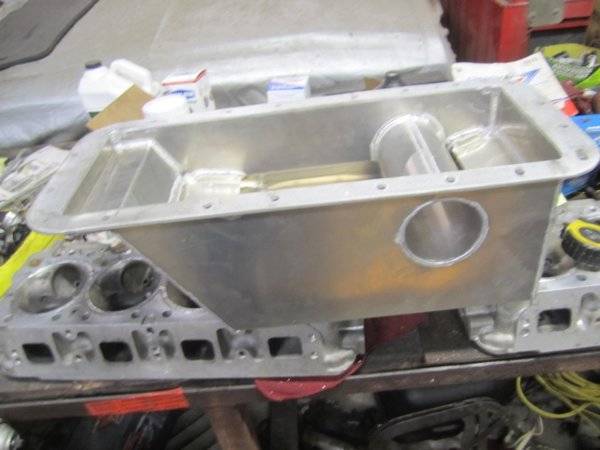

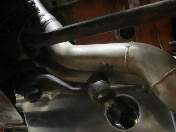

I stuck with the stock stuff and made it work.After adding a "J" bar and midplate the car rode like a new brick.No more "sawing" on the steering wheel.Feels GREAT at 150 MPH.

that is awesome work
