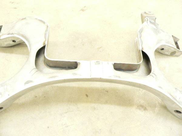

Wow thats a clean k member dont look like its weakened it at all

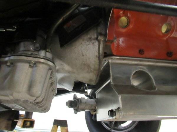

Nearly 500 wheel stands and counting. Boxed the bottom also.
Doug
Obviously your running a front motor plate are you running a rear plate also Doug

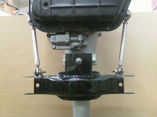

Front plate only. Limiters at the trans controlling fore/aft movement.

Going to pull the k member out of my car this weekend and cut it down thanks for the info Doug

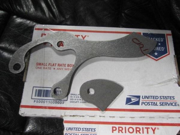

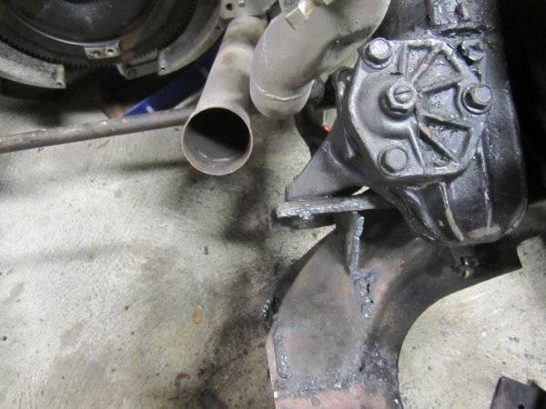

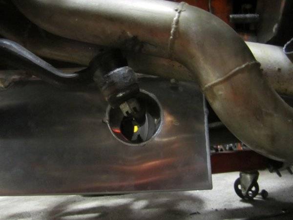

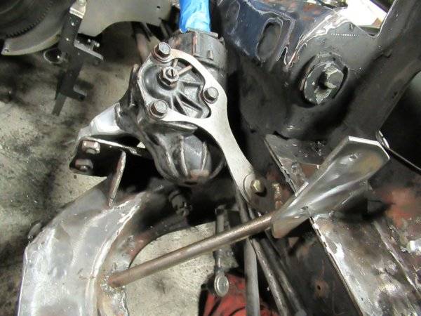

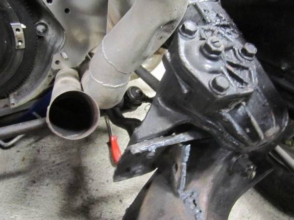

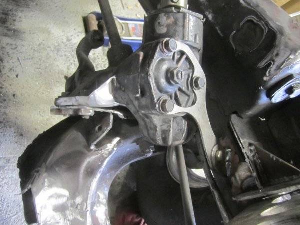

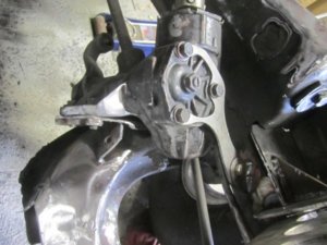

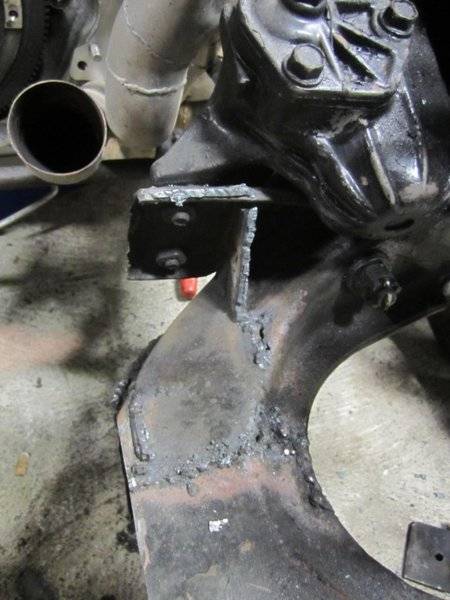

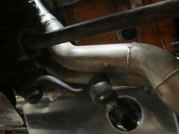

The "K" does not need to be removed ,but can make for a more pretty modification.I followed DVWs idea of cutting the "K" and did it in the car.There was not that much left of the motor mount/steering box mount so these brackets came into use.
2.25.17 012.jpg 3.18.17 026.jpg 3.18.17 027.jpg 3.18.17 029.jpg 4.11.17 008.jpg 5.6.17 007.jpg 5.20.17 021.jpg

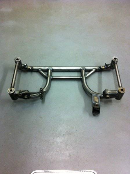

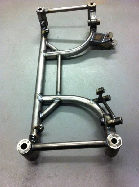

I was going to use the QA1 front K member for my A-body big block drag car, but when I called them to see if it was available without motor mounts, because I'm using an engine plate. I was told No, and when I asked if I could simply cut the mounts off, they told me the structure would be compromised. So I told them no thanks. After a little searching I found a guy on for A-bodies only-(member name-junior636) who fabricates k-members for A-bodies in different configurations, depending on your needs.
I don't know if he has a jig to make it for a B-body, but you can check with him, you never know. He does exceptional work and is a good guy to deal with.
This is the one he just did for my 71 Dart.
I will be installing this k-member with all QA1 components and wilwood brakes.

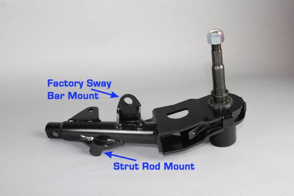

this one it's QA1 k-member
& QA1 LCA's with the sway bar mounts added
SPC dbl adjustable UCA's with poly bushings & ball-joints
QA1 dynamic adj. strut-rods
$450

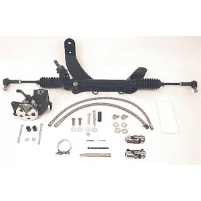

The Uni-Steer power rack & pinion {It's a mod. frt-wd Omni Rack IIRC}
system I bought
is a "rear steer" style system
in the fact it uses the stock lower ball joints, in stock position/locations
& steers from behind the rear of the org. front spindles centerline
it's a bolt in deal, so it was easy, -BUT-

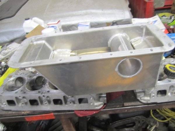

my biggest gripe is, it limits the oil pans & headers you can use too,
far more than anything else, the rest I can live with, no big deal...
{member CDR IIRC had a thread on it here too}

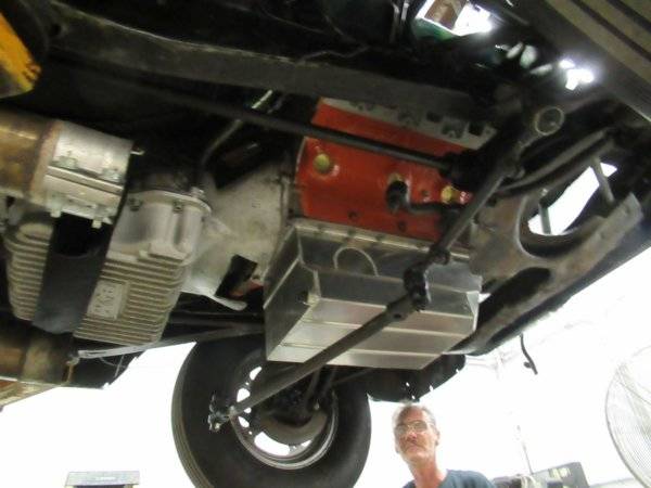

I stuck with the stock stuff and made it work.After adding a "J" bar and midplate the car rode like a new brick.No more "sawing" on the steering wheel.Feels GREAT at 150 MPH.
