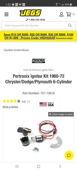

Ima actually using pertronix igniter 3 for my VW engine build but for this car, given it's pretty stock. I was just planning to stay with points.

It seems like the pertronix doesn't seem to care much about voltage fluctuations compared to points, I think you would be happy w pertronix and if you have another issue it will help you sort it out.. I have had a pertronix that was a dud before, but that was when they first came out. Also had one that the same miss happened with points and the igniter, and the only fix was a new distributor. You have done that so I think its unlikely the new one is a dud, but points in some cars is just a struggle, the problems fluctuate as the condition of the points change.

That's the main reason I'm hesitant to ditch the points just yet. It is tempting, but I'm not quit convinced it would actually solve my problem (though I want to believe it)
